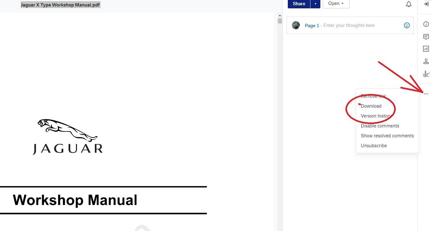

Here is the Manual . . . you can download it using the 3 dots on the right side of the screen.
https://www.dropbox.com/s/xrnoncjq8w...anual.pdf?dl=0
