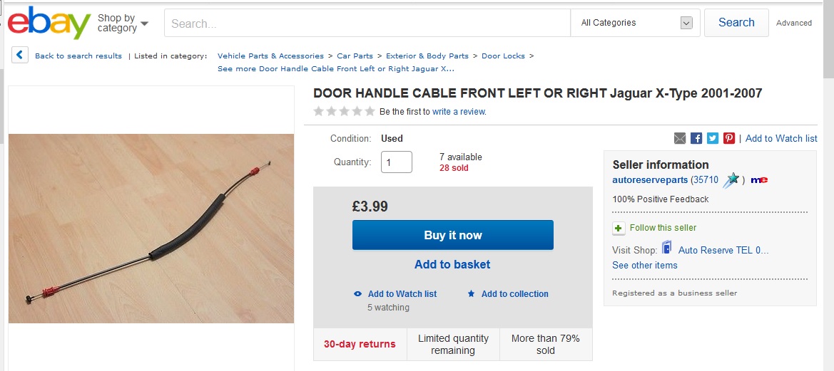

Listed on ebay UK at under 5 Euro. Is this any help?
DOOR HANDLE CABLE FRONT LEFT OR RIGHT Jaguar X-Type 2001-2007 | eBay
Seller lists Estonia as a destination in the postage rates.

I already saw this ad on Ebay, and that would be my last option. 4 quid it is, but postage fee is an extra 10 quid. Plus, delivery time varies from 7-14 days.
Why I asked, because from local scrappy in here I can get Mondy MK3 cable for 8€ without any extras and I can pick it up the same day.
Regards.
