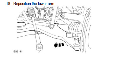

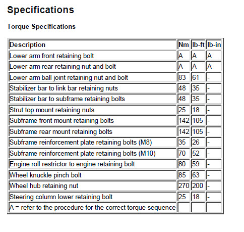

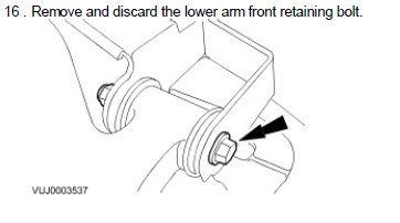

ok easy stuff first jack up and safely support the car
remove the wheels
remove the break caliper and place on an upturned bucket so its not hanging on the rubber break line (new pads here is optional).
remove break disk (new disk optional).
remove tie rod end.
Remove lower ball joint retaining bolt.
To make life a little easier in getting the lower ball joint free from the knuckle.
remove the front lower control arm front bolt completely, the rear bolt remove the nut and drift the bolt up as far as you can until it hits the firewall now pull the lower control arm out pivoting on the rear bolt this saves any damage to the rear bushing.
You are 95% of the way to changing the front wheel bearings at this point all you would need to do is remove the drive shaft nut and you have the knuckle in hand again optional at this point but hey your this far into it
now when you get the knuckle back on the new strut(wooden block and a good hammer), install the lower ball joint first, then install the rear bushing bolt and nut to act as a hinge, now with a dam good push get the front bushing in place (silicon paste helps here) use a large screwdriver or thin pry bar to lift the front bushing the 1-2mm to get the bolt back in can be done alone but i highly suggest a friends help.
Attached Thumbnails Front inner tire wear-front-bolt.jpg   Front inner tire wear-rear-bolt.jpg   Front inner tire wear-swing-out.jpg   Front inner tire wear-torque-spec.jpg
