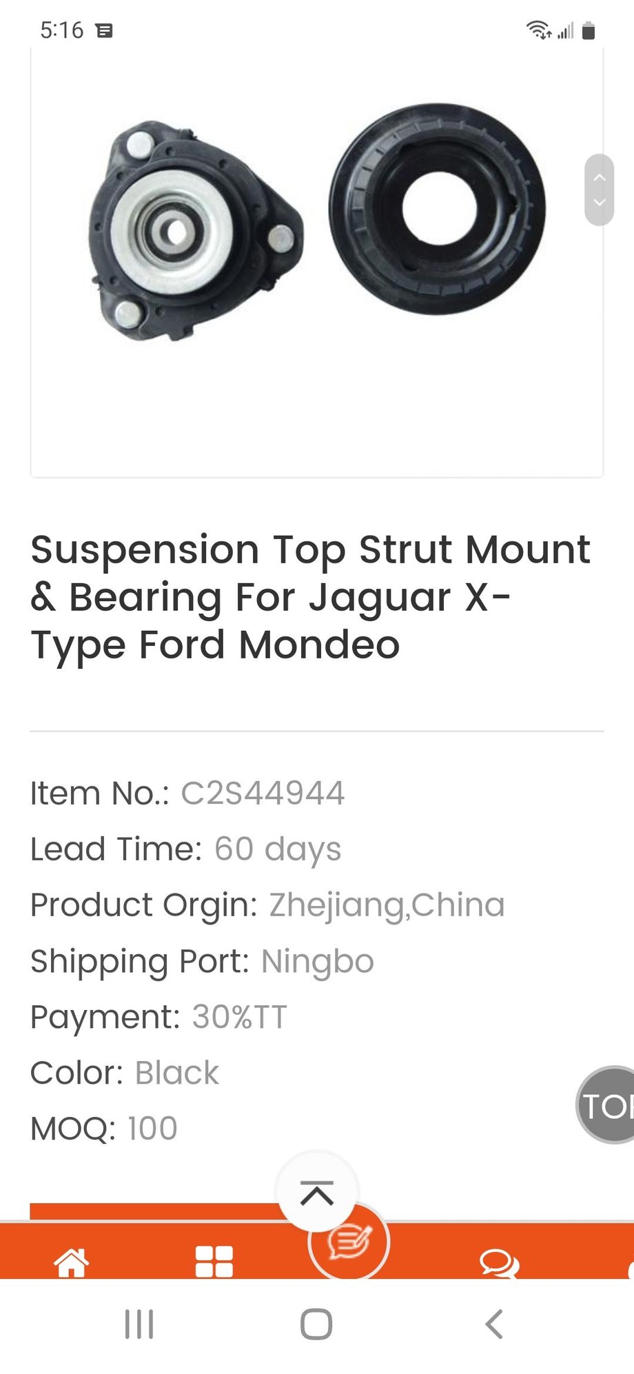

Am panicking a bit now. Have ordered online and given supplier my chassis number and he assured me by email that they will fit. Have noticed that the same part number is listed for the Mondeo on his site. Now I am aware of the many shared parts and have no issue with that but have also read horror stories about top strut mounts not fitting right and leaving the car un driveable..The guys business has 100% positive feedback so I am probably over reacting but I just don't want to end up in a mess.

A few Mondeo front suspension parts work - - rears, NONE at all.

Well that does look identical to what I have ordered and the guy was very thorough with required details when I ordered. (make,model,year and chassis number)..Also he has been selling parts online since 2002 and seems to have good feedback..

I actually followed an AutoDoc (Britain) video on front end replacement that they normally use an X type for, but for this video it was a Mondeo and it was exactly the same process.

Well parts arrived this morning and they look identical to those. Seem quite sturdy so here.s hoping.
