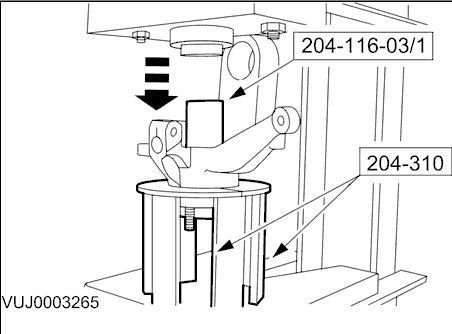

There are several special tools listed in the manual, the one that you really need is 204-310. That's a support to hold the knuckle while the the wheel flange is being pressed out. I made one from the thickest steel that would fit between the knuckle and the flange and when I put it in the press under 8 tons the metal bent and the flange refused to budge. The manual says the bearing will be destroyed in the removal process and I certainly had to resort to brute force to get it out.
If your car has been exposed to salt and winter and there is any chance of rust on the knuckle, be prepared for fight to get the bearing out.
When installing the new bearing make sure it is installed the correct way, as the tone ring for the ABS system is in the bearing. If it's backwards, the ABS won't work.

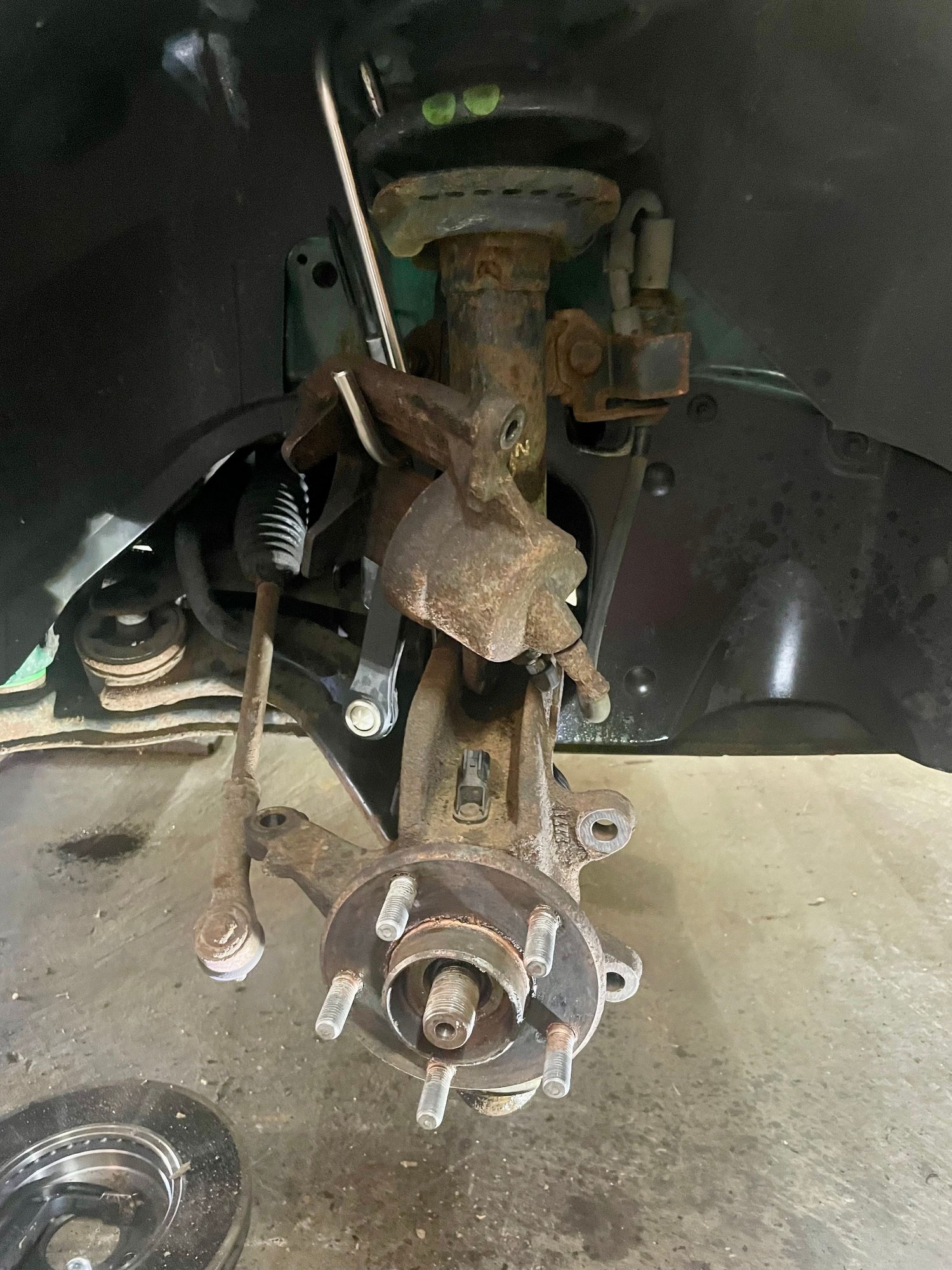

Old Oct 14, 2025 | 07:56 PM
777eleven's Avatar
Joined: Jun 2025
Posts: 27
Lower control arm & strut bolts >
Brand new bearing in the Spindle

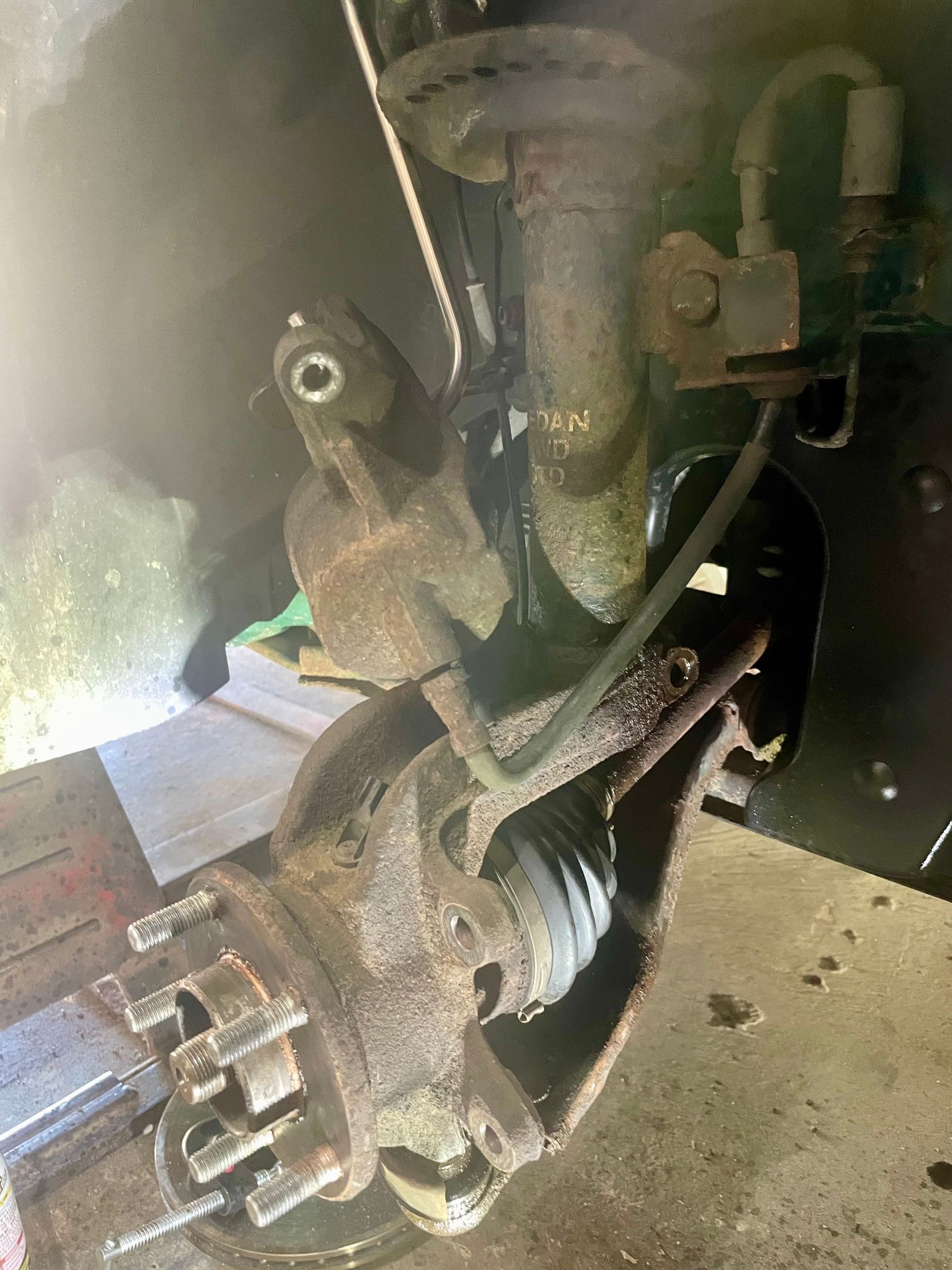

I have done both if mine and as I couldn’t split the shock absorber from the spindle I did it with the leg complete with spring attached on a press, a bit cumbersome but using various sockets and steel blocks it went ok. A tip is when removing the spindle, remove the lower ball joint first before removing the driveshaft nut and pushing the shaft out of the hub, the reason is the angle to get the balljoint out of the spindle is critical or it jams. Especially when refitting, get the driveshaft fully into the hub or the hole on the spindle will never align enough to get the ball joint spigot in the spindle, the spindle needs to be fully in towards tge centre of the car or you will struggle as I did for 2 hours before I figured out the the drive shaft wasn’t fully in and was holding the spindle out an angle.
