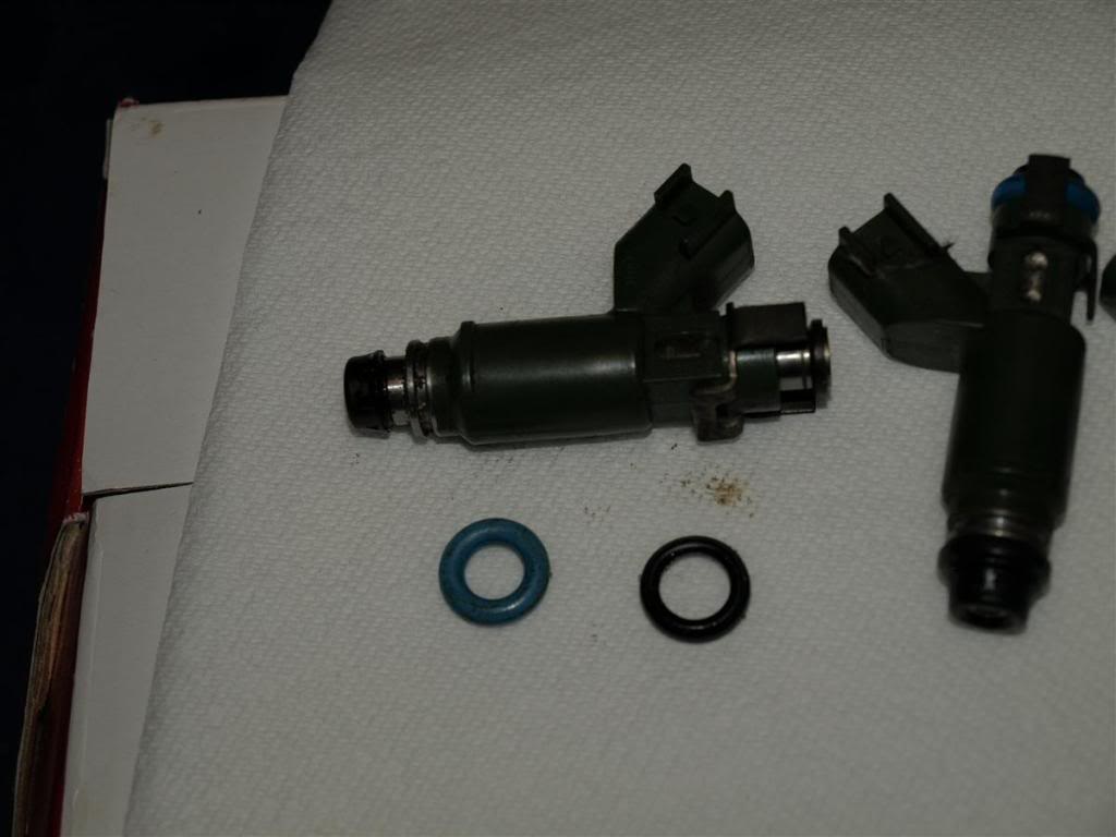

Here is what I am dealing with. Auto Zone, Advanced, PepBoys and Napa all offer a black version of the blue o-ring below. I had them check the 2003 Lincoln LS 3.0 and a few other cars they all came back with the same part. I cant find a replacement for the smaller black o-ring
As for the blue o-ring, that looks a lot like the o-rings used on a 5.4L engine used in the ford trucks (F-150, Expedition, Navigator, F-250/350). So, you may want to take the o-ring in and see if they can pull down a box of those o-rings and see if they match up.
As for the thinner (black) o-ring, you should be able to go over to the o-ring center at your local parts store and find something that is really close. Most of the o-rings that you will find are going to be nitrile o-rings and they will stand up to gasoline.

I called Ford to see if they can get me a set of o-rings for a 2004 Lincoln LS 3.0 They can get the top (blue in my picture) o-ring that I can find just about anywhere around here. The smaller bottom ring (black) is not serviceable and do not offer replacements
. They would have to order a whole new set of injectors to replace the o-ring. I get the same answer from Jaguar and britishparts. I have gone to local shops that specialize in injectors and others that have random o-rings and none carry the correct size for the smaller ring. Any other suggestions

Found the o-rings at a local bearing shop of all places. If anyone ever comes across this post and cant find them locally send me a message. I would be more then happy to grab some and ship them out.

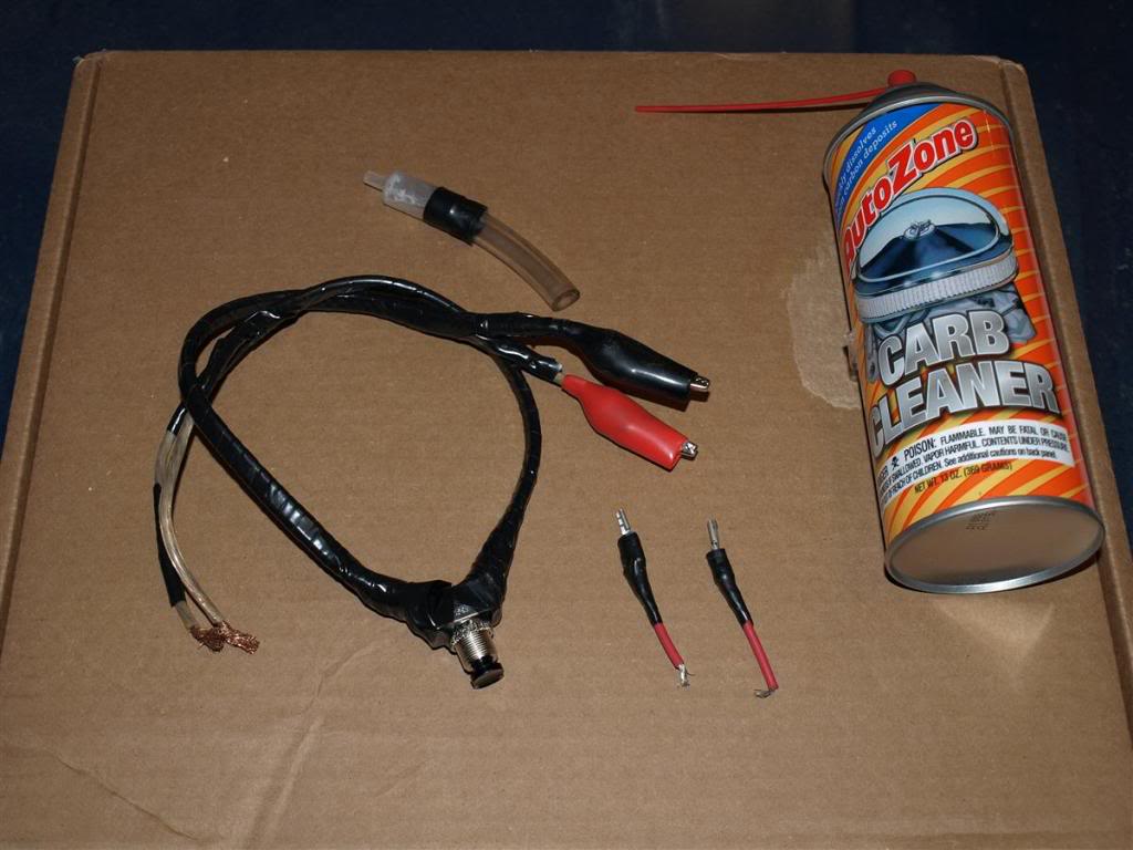

I used this video ( http://www.youtube.com/watch?v=VFJlTfHyrUk ) and had to make a few modifications. In the end I was able to test and clean all my injectors.
I found them at drivewire.com (00 2000 Jaguar S-Type Fuel Injector Seal - Fuel Injection - OES Genuine | Drivewire.com ). Yes, these are for the "s-type" but they are the same as the x-type. DO NOT look for them after 03 -reason most of our online supply shops go by MFR's report as non serviceable. When in fact the MFR used the very same injectors for several years. I have them in my 07 x-type! Same injectors as my 02 x-type and my 04 s-type. Go figure! I'm not too suprised. Here are the web-site pics.

I know this is a very old thread but I found it when looking for injector O-ring info. Upper O-rings are sold as O-rings, lower O-rings are usually called seals even though they are just different O-rings. Upper O-rings are very easy to find, lowers not as easy but are available from the usual Jag specialty shops: SNG Barratt, jagbits, terrysjag
Upper Injector O-ring: C2C19756
Lower O-ring / seal: C2C19757
GB Remanufacturing sells both as a set, their part number 8-051. Right now a set of these at Rock Auto is $3, less than either an upper or a lower from the Jag parts suppliers. GB Remanufacturing has a buyers guide listing all the applications with the same O-rings. The list is pages and pages long. Here in the US of note they are the same as the O-rings on the 2003-2010 Ford F-150 5.4L which was the largest selling vehicle in the world for most of those years, so there must be some inexpensive Ford aftermarket parts.
