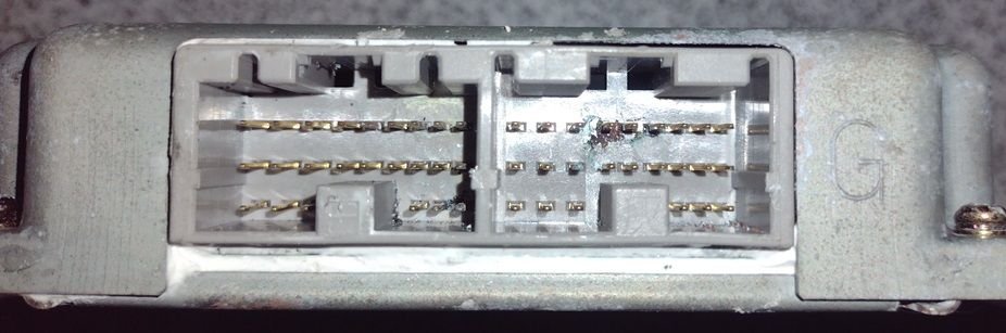

Of course in the middle of all this I found what is probably the real fault, corrosion in the TCM connector. I'll address that and knock on wood and cross fingers and see if the gearbox lives.
