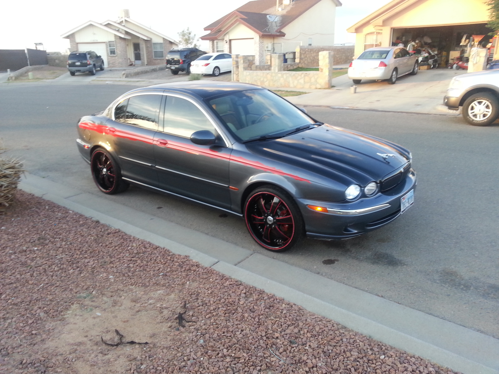

nice job, I'll Wrap my interior too, but for now just finished my hood,roof,wheels and trunk with 3m 1080 gloss black metallic. I recomend this 1080 vinyl very easy to apply and look like a real metallic paint job.

Nice ride and from my neck of the woods!! the neighborhood looks familiar....lol

Lol ! man I'm at the NE nice to meet you !
