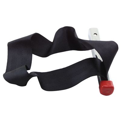

I use one of these for oil filters - Sealey, great bit of kit:
