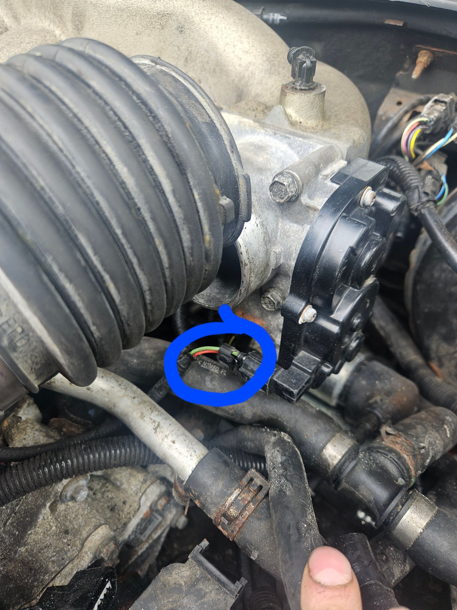

What plug is this while moving things around when i was working on it i crushed it 2003 xtype 2.5 manuel thank you u for any input.

That plug is for the throttle body. That is what powers the motor that controls the throttle body and also has the position sensors. This plug is known to destroy itself due to under hood temps. If you do some looking around the forums, you should be able to find the part number to the plastic part of the plug and be able to recreate the connector.
