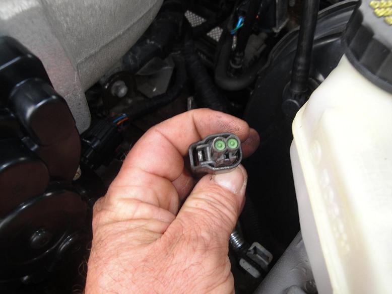

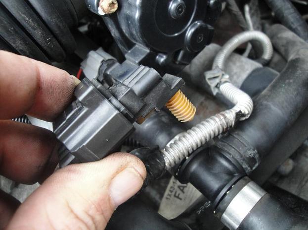

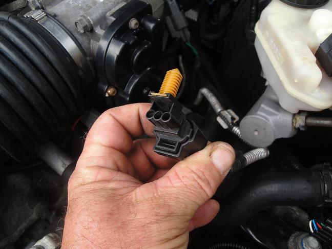

is there any one out there that may recognize these plugs, I've looked every where and can't find where they would plug in. both plugs seem to be coming from the starter.
02 x type 2.5

Those are dummy plugs sealing the elements out of harness connectors that are not used on your car. I believe those in particular would be used if the car was equipped with a manual transmission.

Hi Steve Thanks for your reply, sorry for the laps in getting back, my 02 x has many issues that I'm going to start on addressing now that the warmer weather has hit but i was wondering if it"s OK to remove the one plug that has the aluminum shield around it and cap off the wires, the shield has melded, I've pulled the shield back and separated the wires, but not sure if that would cause any other trouble !!
Thanks again for your input!!
