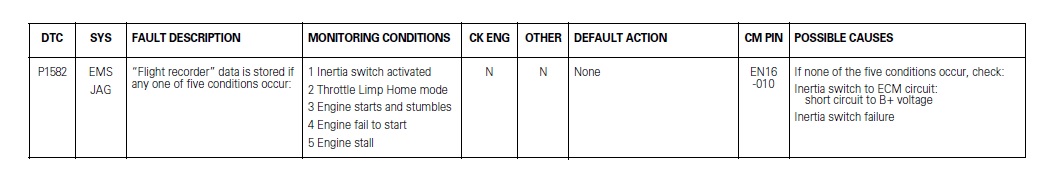

Here is the extract for P1582 from the Jaguar DTC listing for the X-Type showing possible causes:
I would question what scantool they are using to show code 9582.
Thank you for this.
None of the 5 things listed has happened and the car is running fine.
They used 2 different machines to read the code as it kept saying unknown code 9582 and that's the bit that's throwing them.
