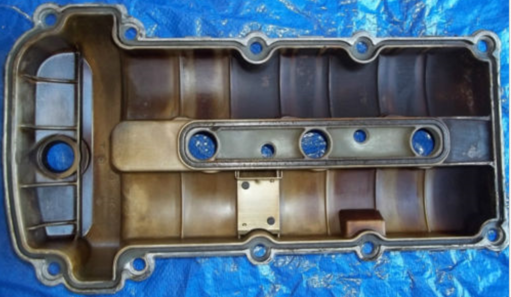

Dmitry: When oil leaks into the common spark plug well, it can cause all 3 spark plugs on the same bank to misfire.
If you buy this car, expect to remove the intake manifold and find oil around spark plugs 1, 3 & 5, the firewall bank. The repair is not difficult or costly if you do it yourself: remove the valve cover and replace the gasket around the spark plug well - it fits the rectangular groove in the valve cover (picture attached). Clean the spark plugs, or better yet, replace them - they're likely fouled by misfires. Also clean and inspect the coil boots for arcing damage. I'd do both banks, and replace the intake manifold gaskets & IMT O-rings while the intake is off.
Does the check engine light blink or stay on all the time. Since you don't know how long it's been driven with a misfiring engine, the health of the catalytic converters is a concern. P1313 & P1316 point to problems with the Bank 1 converter. A blinking CEL is an added warning that a catalytic converter is either already damaged or being damaged, probably by unburned fuel in cylinder 1, 3 & 5 exhaust. Replacing spark plugs and valve cover gaskets is relatively easy & cheap if you do it yourself. Replacing a damaged catalytic converter is more challenging & expensive.
I'll let others comment on P1384 & P1396 - variable valve timing issues.
Having said that, 70K miles is very low on a 2002. If the body is in decent shape, the price is right, and you have the passion to work on your own car, this could be a very good deal. But if a dealership does all your car repairs, there's probably a better X-Type out there waiting for you.
