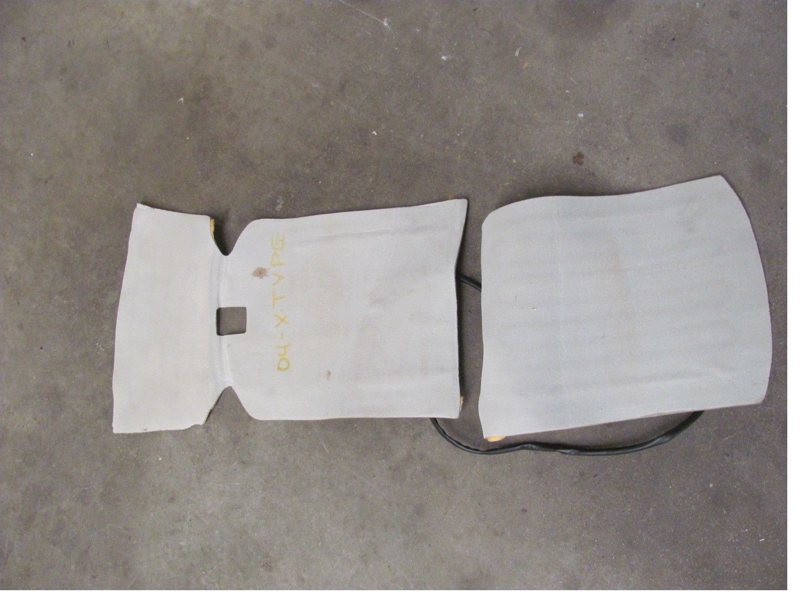

1 - Seat heater elements w/harness (2) - around $65/ea, used
Attachment 92193

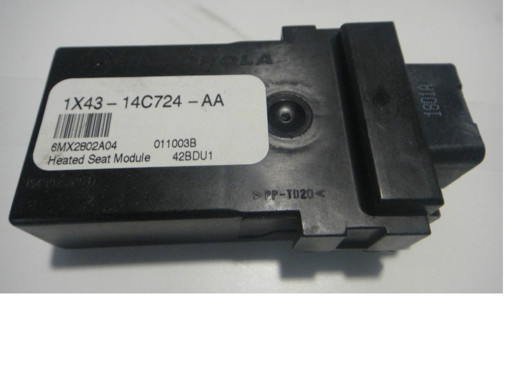

2 - Seat heater modules w/harness (2) - around $50/ea, used
Attachment 92194

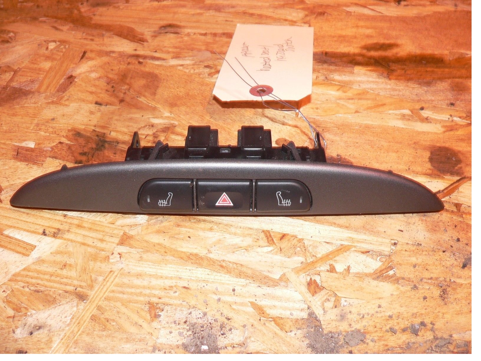

3 - Three-way hazard/seat heater switch (1) - around $20, used

You will need to strip the covers off each seat to install the heating elements. This a pretty involved process. Download Jag X Type workshop manual from internet for step by step instructions.
You can attach the module to the bottom of the seat. My factory installed module is attached to the front area of bottom cushion metal pan.
You will need to replace the single function hazard switch on the console with a 3-switch module for the hazard and seat heaters (See thread above).
Regardless of whether you replace the seats or upgrade your own seats, you will need to use the 3-switch hazard/seat heater switch on the console.
