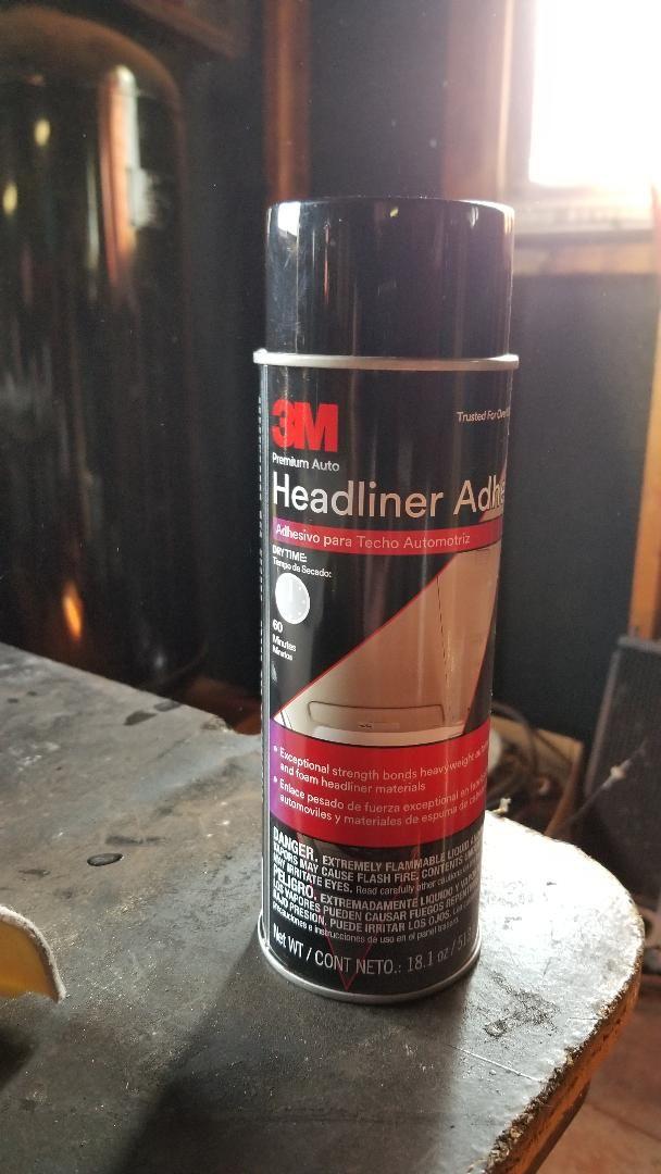

I used to replace headliners professionally in my younger years. It's actually not that hard. Removing the headliner can be tedious, but I've gotten them out in some tight situations. You can order the material online. You need to make sure you remove all the old foam and use the correct adhesive. We always used contact cement, but 3M makes a headliner adhesive that's rated for the high temps of car interiors. Don't use regular spray adhesive. It will fail in the heat and headliner will come down. I'm actually about to do mine in a '04 X-Type. I'll let you know how it goes.

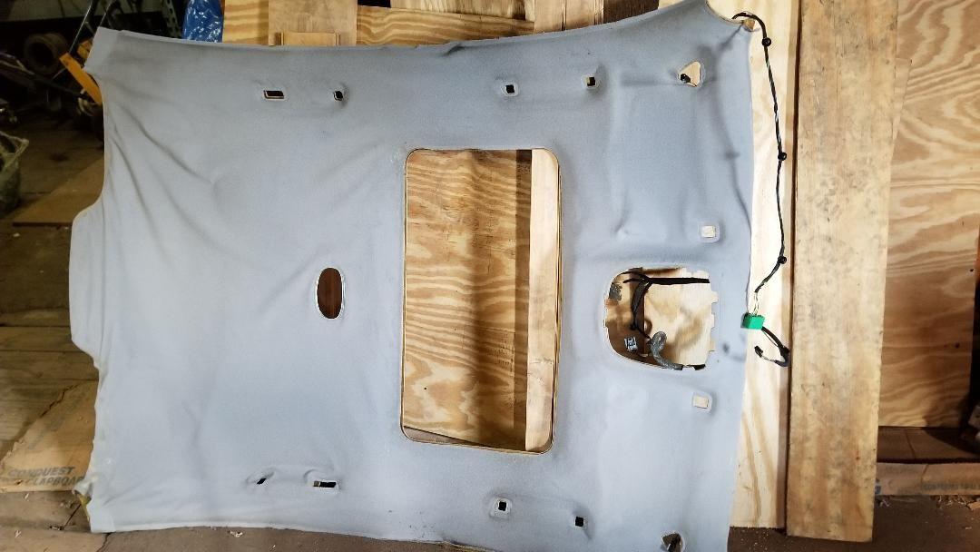

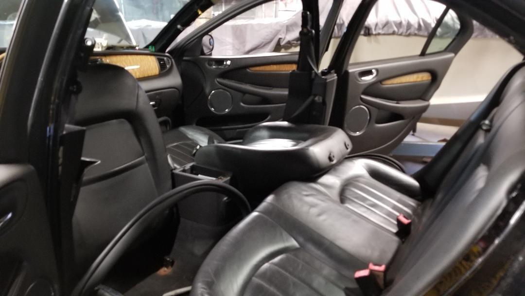

Got it out. Had to remove the center console lid and fanagle the seats up and down but came out through the left rear door
Old Sep 24, 2021 | 08:46 PM
Holland's Avatar
Joined: Jul 2021
Posts: 27
From: Buffalo
What I Had

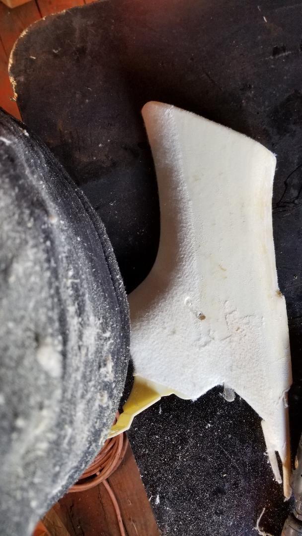

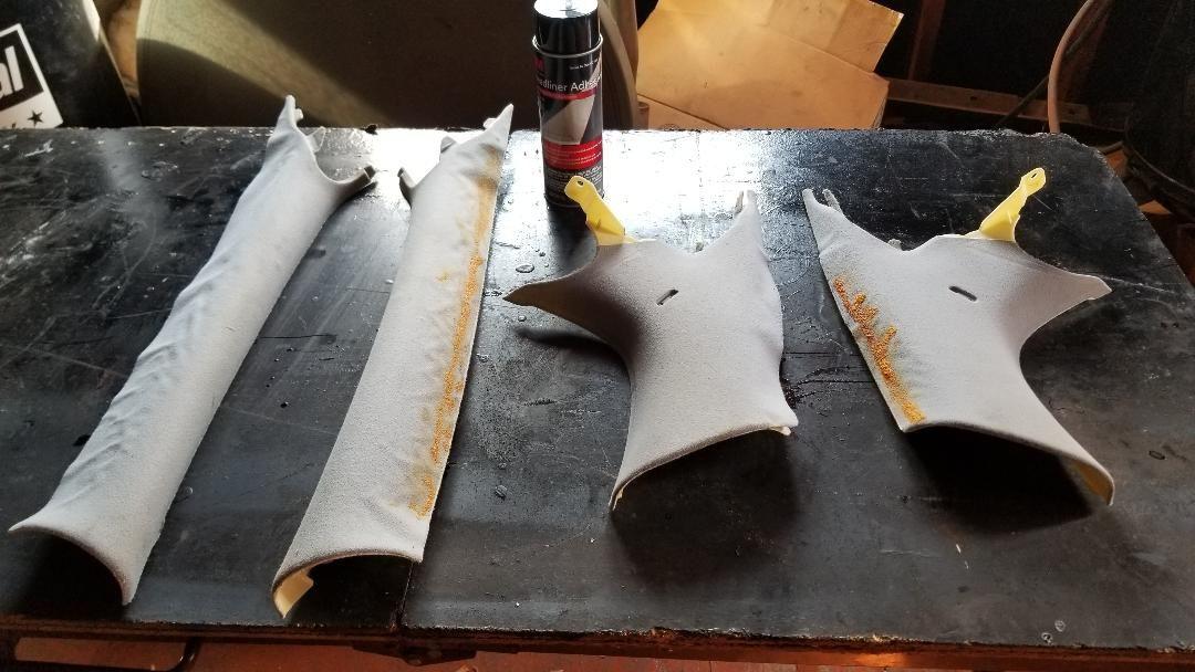

A and C Pillars. Not sure what previous owner used,
thinking Gorilla Glue
Old Sep 24, 2021 | 08:49 PM
Holland's Avatar
Joined: Jul 2021
Posts: 27
From: Buffalo
Removing the foam suuuuckks!

This is the adhesive
