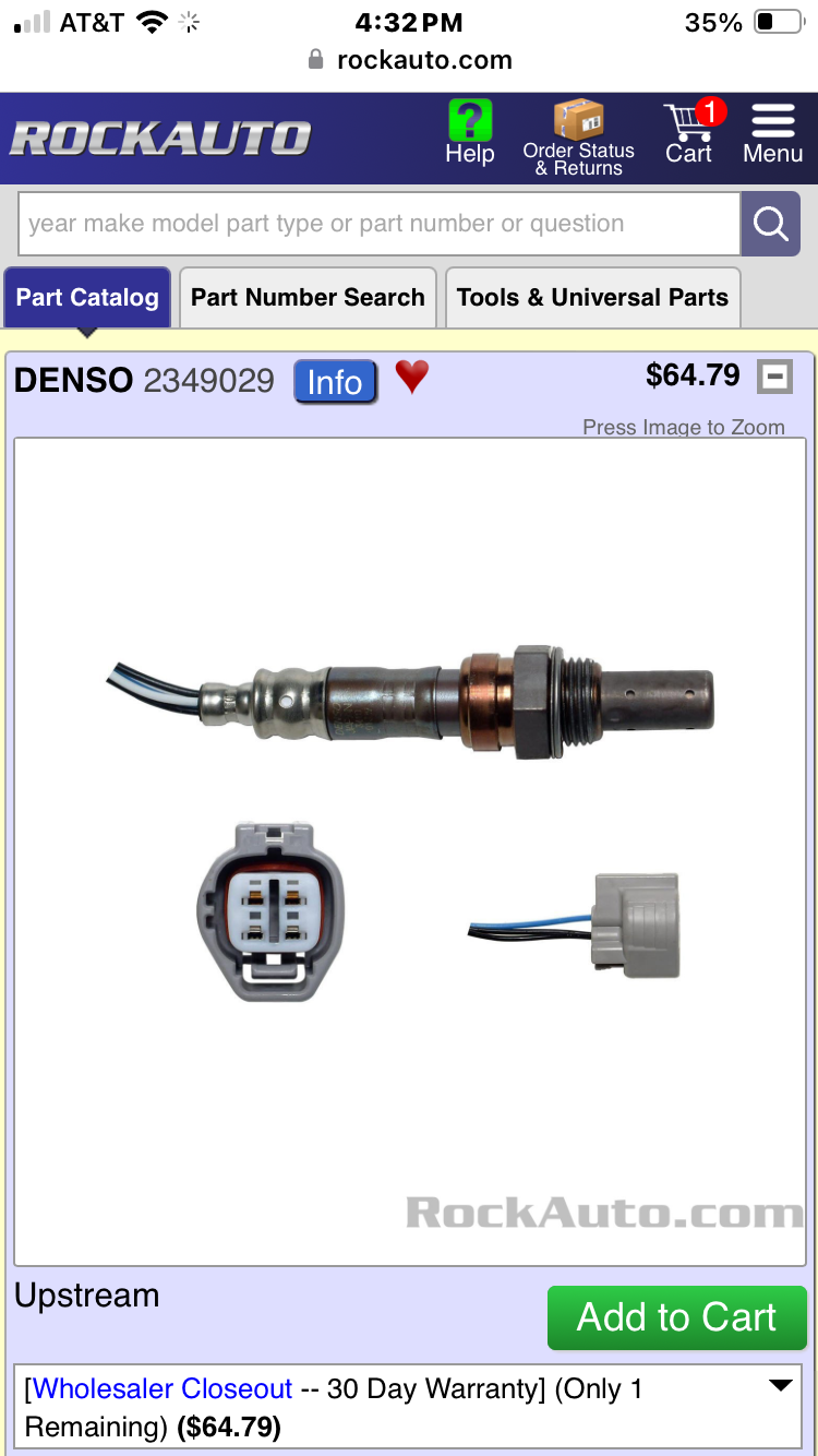

Thermo. Is this the correct O2 sensor for my 2006. Lemme know please. Thx.
Old Feb 7, 2024 | 04:26 PM
Thermo's Avatar
Veteran: Navy
Joined: May 2008
Posts: 14,803
Likes: 4,104
From: Great Mills, MD
NYC, yes, that is the correct one.

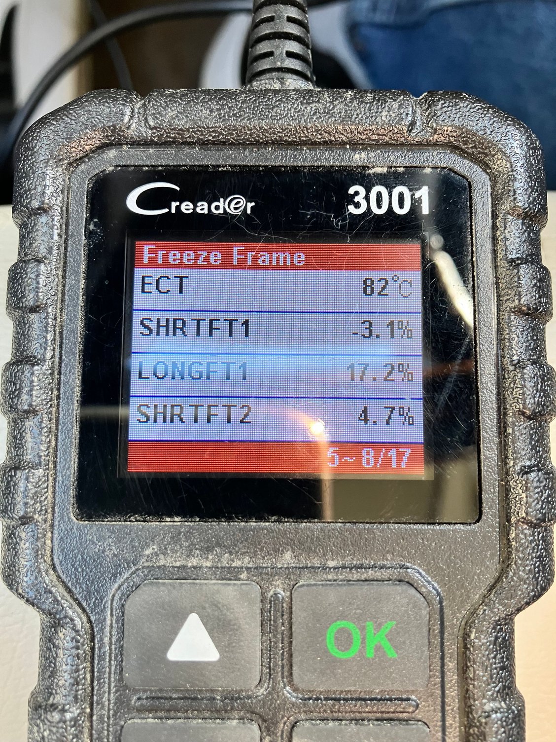

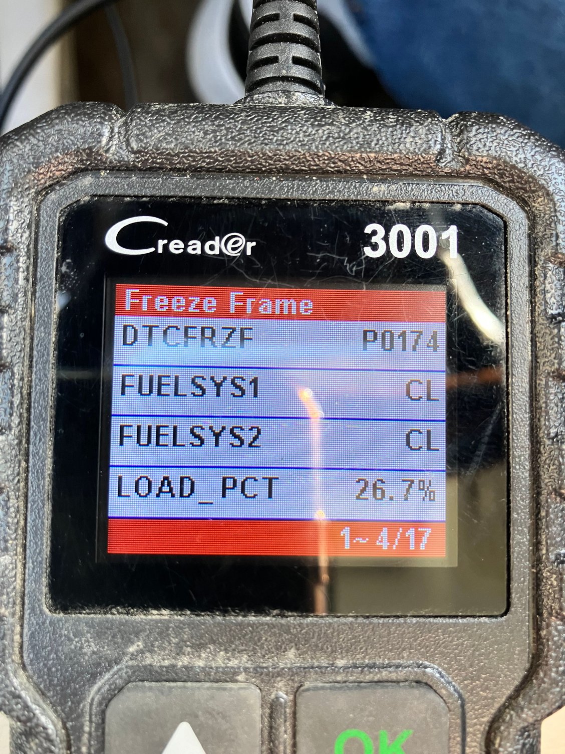

Default Freeze frame scan tool data. Someone please advise
Ordered a new bank 2 upstream o2 sensor. Haven’t had a chance to install it yet. But here’s what’s happening. P0171-0174 for months. Changed big 3. New brake booster. New fitting on intake manifold. Same codes keep coming back. Can’t pass inspection since last October!!! So almost a month ago. I cleaned the maf sensor and that seemed to get rid of P0171. Wasn’t even showing as pending. Yesterday checked codes. P0174 current. And P0171 pending again !!! I did a data log with freeze frame on my c-reader scan tool. Here’s what’s showing. Any help please on this. Sick of throwing parts and money at this problem and never gets resolved. Car starts and runs fine. Good gas mileage. I get the 3000 rpm limit when the check engine light comes on. Clear the code and light. And car flys over 3000 rpm with a lot of power to spare. Please help
to decipher this freeze frame data. Gotta get this fixed. Losing my patience. Thx for any help.

Default Anyone with knowledge of code readers please help
Got the freeze frame data when my code was set. Anyone able to pin point my problem please
