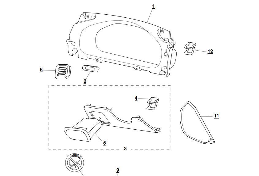

To access it you need to remove the lower dash panel. I think I remember it just prying it forward and off. One pin at each corner and one in upper center next to steering column.
Old Jul 5, 2020 | 04:13 PM
avern1's Avatar
Joined: May 2012
Posts: 3,290
Likes: 1,328
From: Winchester, CA
It took me a minute but here is a picture of the lower shroud.

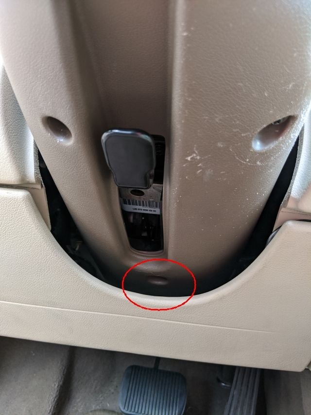

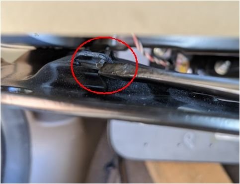

It turns out my lower dash was held on in a different manner than expected (maybe because I have a knee airbag). There were two upper torx screws exposed by pulling back on the panel, and two lower torx screws as well. In addition toward the top were two fasteners that were held in by spring clips that I was clued in on by this post.I had to pull back on a bracket and push against the spring with a flat head screwdriver while pulling out on the panel. I've attached some photos below in case anyone else runs into this issue.
The fastener in the foreground was held in by a spring clip behind the bracket.
By pulling back on the bracket I was able to push the spring clip to the side to release the fastener.

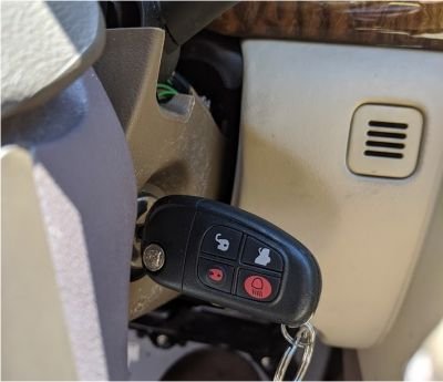

After that I was able to remove the lower dash panel and access the third screw in the steering column shroud. And I was able to remove the top half of the shroud, but unfortunately not the bottom half. I need to remove the bottom half so that I can hopefully expose the pin on the ignition barrel that will allow me to remove the barrel. I can't get the lower shroud around my stuck key.
Key is blocking removal of lower shroud.

I was able to get the lower shroud off by removing the key from the key fob. I pried the key fob apart with a screwdriver, and then was able to get the shroud around the body of the key.

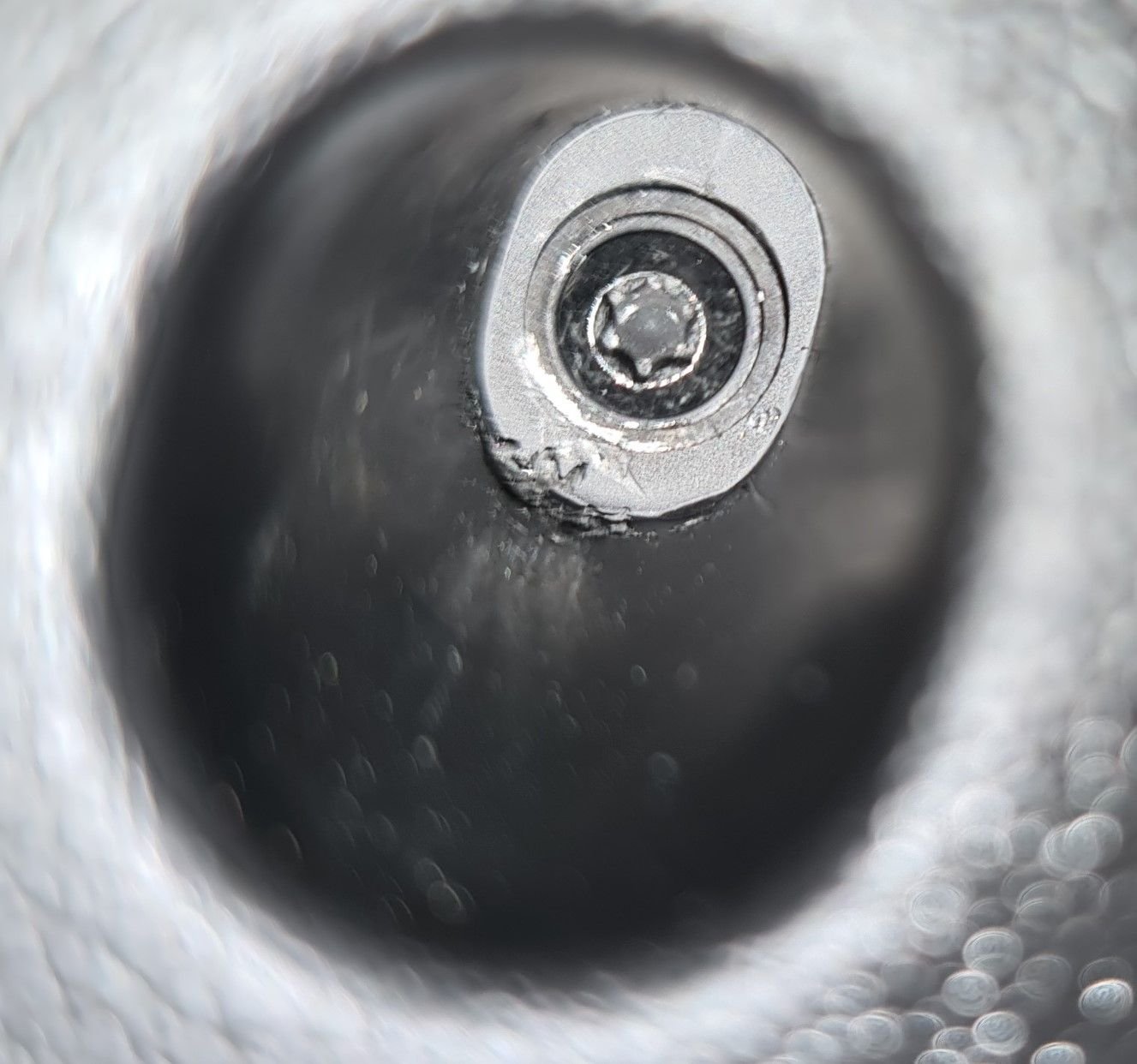

How did you get that bollom screw out
as the one I have looks like this

Hmm... Mine was a torx screw. I really don't recognize what type of screw head that is on your car.

Looks like a security female e-torx. Easy to find sets nearly anywhere.
