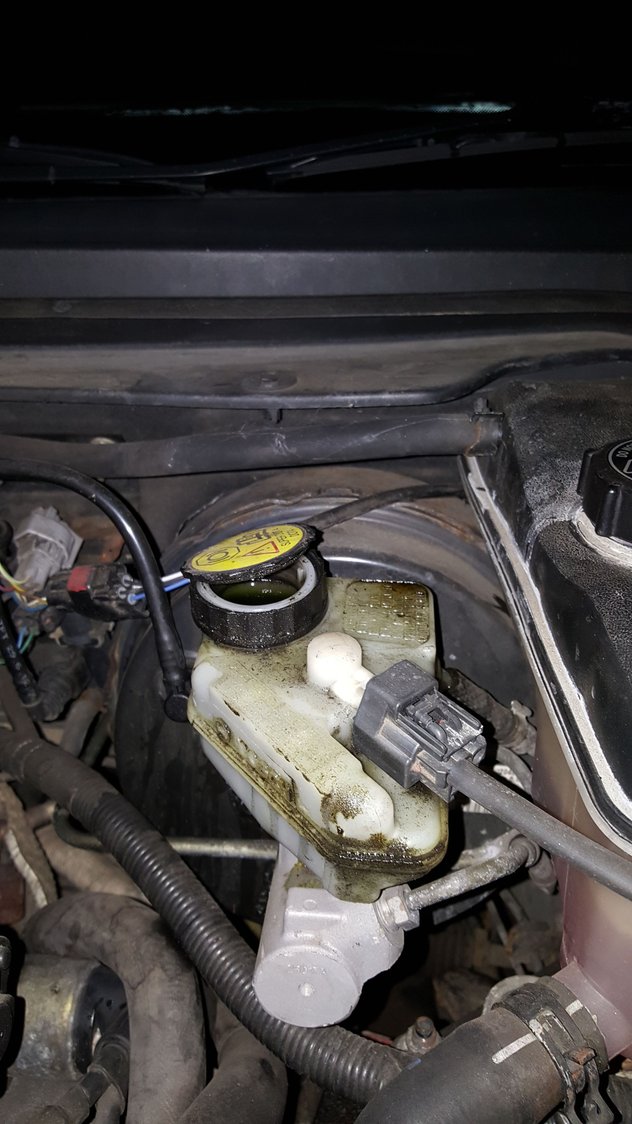

I pull over and expect to see all the coolant gone, but it was still there and not under excessive pressure. I re-checked for signs of head gasket faliure. All seemed ok. I noticed a slight leak of coolant from arounf the thermostat housing, but this had clearly been here for some time and was very small. I was a bit confused at this point. I allowed time for it to cool and decided to move it to the next services. Just before I get there the same thing happened, Cruise control warning, then shortly after, Engine temp rockets up suddenly. This made me feel a bit better as it indicated it was more likely an electrical issue. I pulled in, turned off the car and ignition. Waited a few seconds, turned ignition back on and temp guage was showing normal. Happy that it wasnt overheating I drove it back.

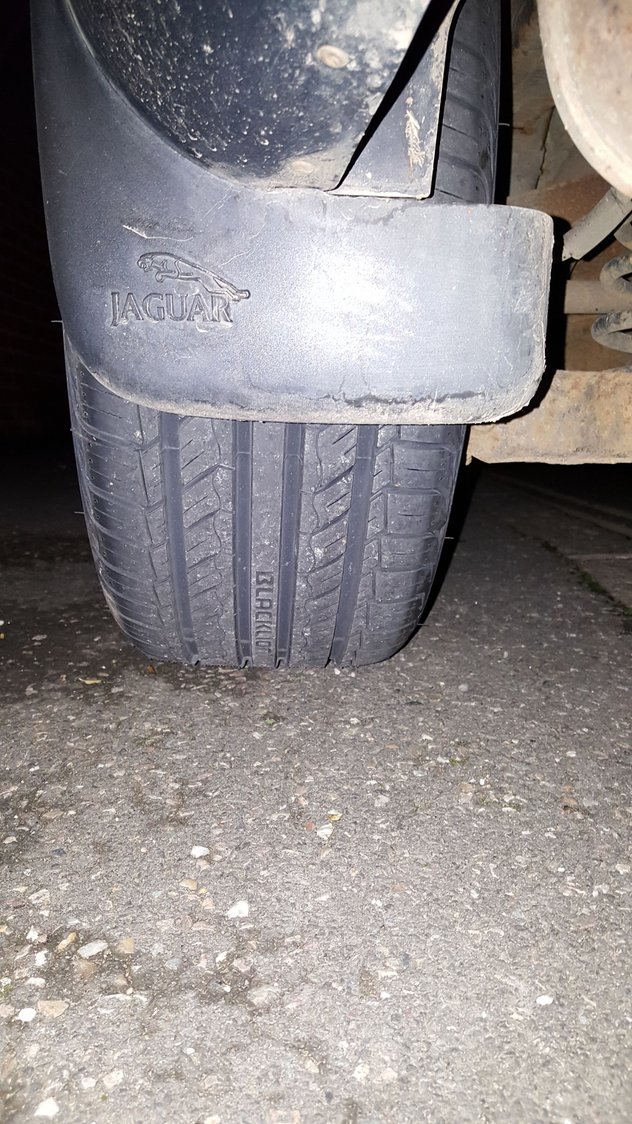

Picked up the car, clutch all done and on the way back I stopped off and got 4 new tyres fitted. I got budget tyres (£159 with discount (RRP = £200)) because later down the line I'll get a new set with the new wheels. Tyre fitters informed me the rear brakes are almost down to metal. And since having the clutch done, the brake fluid reservoir has blown off!! So 3 problems solved today, and 2 more discovered. But it's progress nonetheless. I'll be jumping forward a few steps and ordering uprated brakes, lines and obviously a new reservoir cap. Unlike the tyres which are cheaper, easier to change and can be kept as a spare winter wheel set, I don't want to spend out twice on brakes, or to do the work twice. ��

Welcome to the forum. Some quick comments
The brake fluid reservoir has blown off!
The photo shows a split cap. Probably split in an earlier life.
I would not drive a car if the cap had really blown off or drive it with a new cap until the reason is found.
Lack of a sealed reservoir is a good reason to test for water in the fluid and/or replace the fluid.

Yes the cap has split, its just another term for it, the pressure has pushed it an caused it to split like it did. the same way pressure in the atmoshphere pushes air, i.e wind blows, or an explosion blows up... something like that anyway. I could see by the paint bubbling off the servo that it must have been split prior to the clutch change as you mentioned.

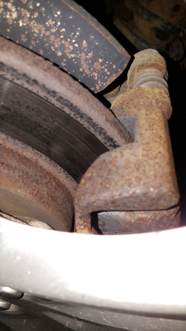

I decided to stick some budget brakes on for the time being
