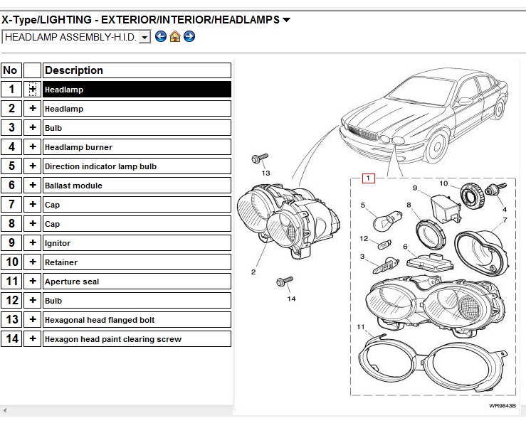

Here's the Parts Catalogue page for the HID Headlamp assembly:
Ballast Module (item 6) is listed as Part Number C2S15079

Thanks for the help mod,
but in all honesty, I am not looking forward to paying $450/piece for a module - that honestly sounds extremely ridiculous for a part. Any ideas where to find them at a cheaper price?
