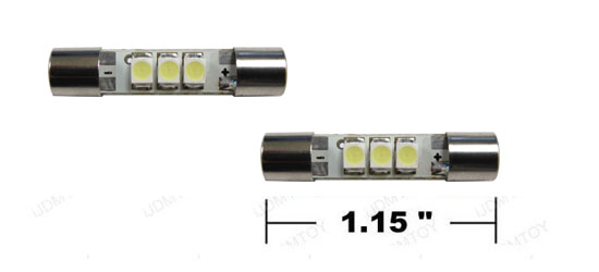

Note to the thread viewers, I made a minor mistake as to the visors/flip down mirrors bulbs, the bulbs that I posted are too big, and I will have to find a different bulb for this. Sorry for any inconveniences.
There are no LED's availble in that exact size, I found some close which needed a little work to get them in;
TS-14V1CP F30-WHP 6614F 3-SMD LED Vanity Lights | Sun Visor LED
To fit them I had to bend the copper tabs that hold the original bulbs, at right angles, just the tip, so they grab the ends of the LED which have slight indentations in them.
