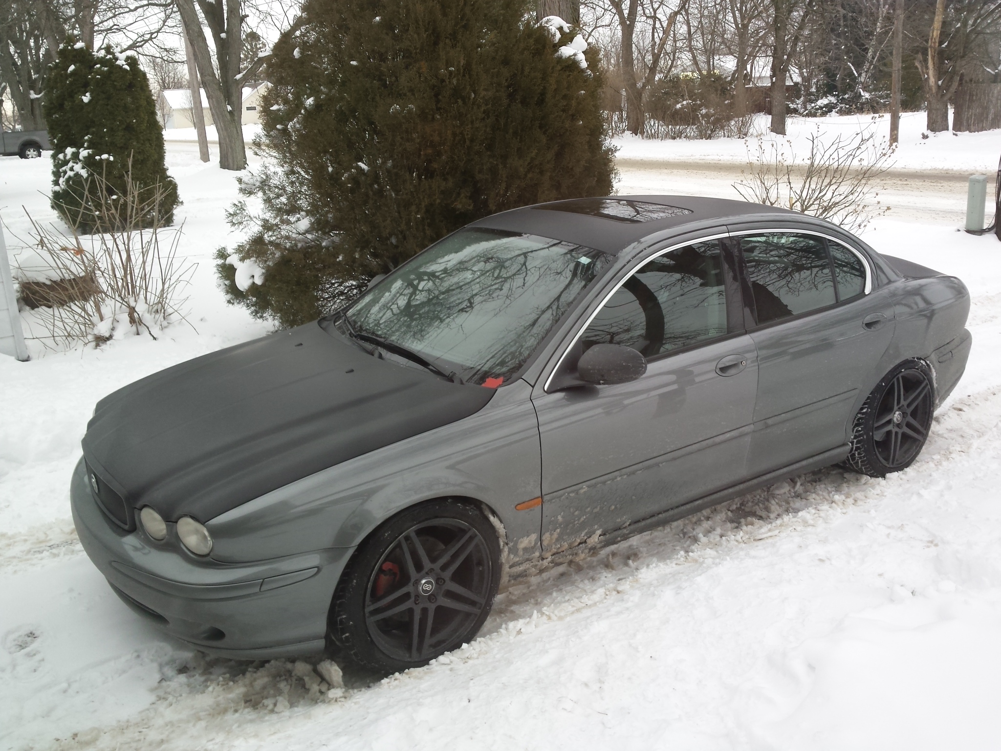

I'm getting the wheels powdercoated a bright red/orange in like 2 weeks. It's so much cheaper than I ever thought it would be! I would have done it a while back if I would have know! I'm just waiting on a replacement wheel from tire rack, the ex mangled the driver front on a curb! I'm also going to finish wrapping it matte black. I tried selling the vinyl I had leftover but no one bought it so I'm just going to finish the job! ***** hard to do though!
