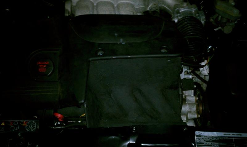

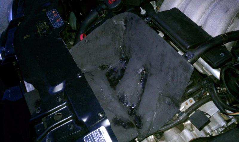

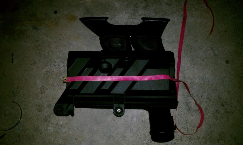

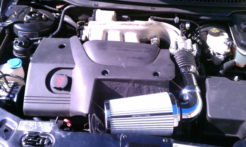

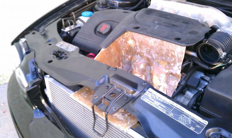

Read a lot on "Cold Air Intake" here and noticed many people bashed it for not actually taking in "cold air". Those who did the "hot Air" mod noted that they did it more for looks and sound,not so much for performance. It does look cool,it does make the car sound better...and the way I made mine,it does take in "Cold Air".
Heres some threads I've read :
https://www.jaguarforums.com/forum/x...-intake-54961/
https://www.jaguarforums.com/forum/x...pgrades-57555/
I basicly copied this one (but he cleaned his up better)....
https://www.jaguarforums.com/forum/x...der-$75-36481/
But I made mine with a custom fiberglass barrier,coated in high heat resistant paint,and extended forward with a port/scoop for better "Cold Air" intaking.
Parts you'll need with part numbers:
8708-this is 4in straight piece. Make sure its the one with the sensor hole
8701-mounting kit
8698-90 degree tube
889881-Filter
Fiberglass sheets
Fiberglass resin & Resin Hardener
Bondo & Hardener
High Heat Resistant Paint
Attached Thumbnails Intake Project DONE!-imag0686.jpg   Intake Project DONE!-1.jpg   Intake Project DONE!-2.jpg   Intake Project DONE!-3.jpg   Intake Project DONE!-4.jpg

That's hot. I have a piece of ABS in the same location, but yours looks more heat resistant. You sure you don't want to use some filler on it to get rid of the chunkiness/adobe look?
On second thought, I would actually say use some black Dynamat-like heat shielding. It will conform to the curves and reflect heat. $20 or so on ebay.

The heat is NOTICEABLY reduced,both to touch and on the highway this thing breathes way better shoots forward and sounds great.
I was going to bondo it better,sand and clean up but I got anxious to put it in and skipped that step..haha

From: Bedford, Indiana
I'm considering doing this soooo much, like it looks sooo damn nice. But I have a few questions. Is there any way that I could attach a K&N Filter instead of Spectre? If not, then it's all cool. Then.. is it safe for the car?
Old Aug 10, 2011 | 11:55 PM
BlackXBlackX's Avatar
Joined: Jul 2011
Posts: 30
From: Gardena CA USA
The spectre has a bunch of rubber pieces where it connects to the pipe that you could take out to conform to bigger or smaller pipes. Check if the K&N has that too and you'll be fine. I had no probs with my mod,NO computer reset needed or anything.

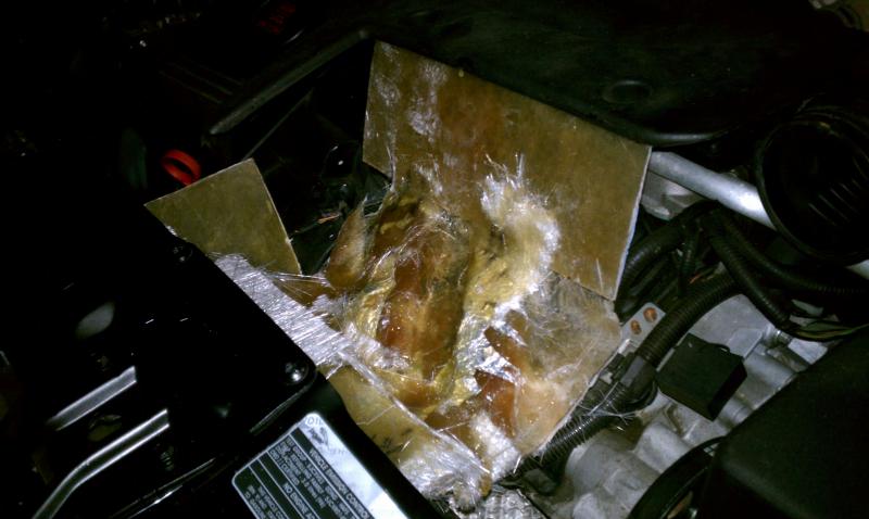

From: Alabama
@BlackX what was the "releasing agent" you used to create a barrier between the fiberglass and the motor? Wax papper?
Old Aug 11, 2011 | 11:42 AM
Joined: Jul 2011
Posts: 30
There's special release wax you could buy,but I couldnt find any so I used regular candle wax and it worked..lol What I did is lay down aluminum foil first and rubbed a regular candle on it then used the foil to mold the bottom of the stock intake box. Once I had the bottom plate I measured and made custom flat pieces of fiberglass,then figerglassed all the pieces together and used a grinder to clean al the edges.

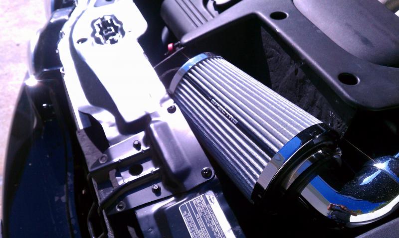

I left out an IMPORTANT part.
On the pic where it already painted black but still looks wet,you could see on the back that I added some metal brackets. Those attach to the plastic engine cover and the small plastic black box that comes off the intake hose.
