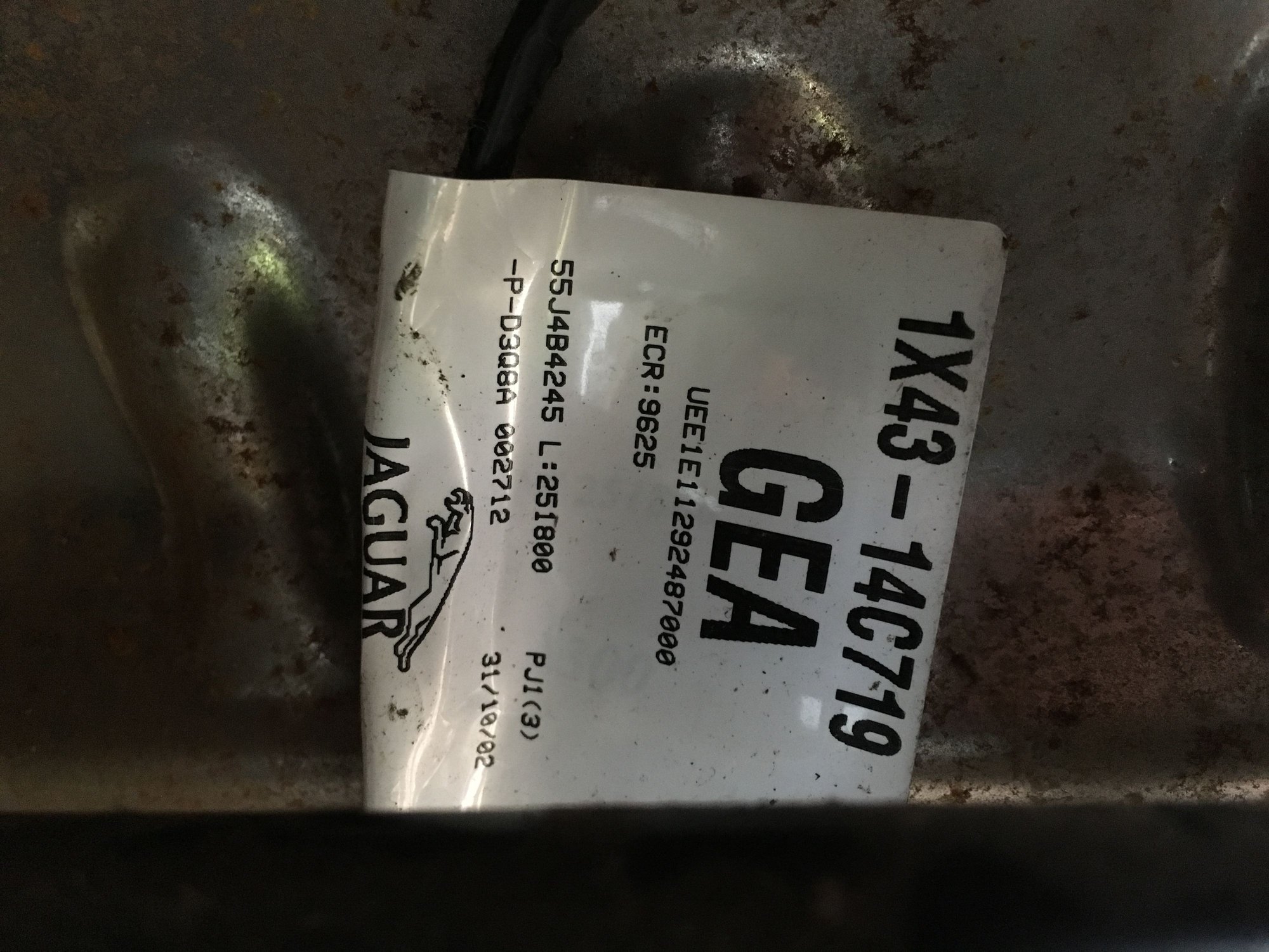

Hi, hope someone can help me out. I've brought a set of front jag x type seats that I want to fit in a camper conversion but I can't find a wiring diagrams that matches the cable colours I have. The seats have the controls and the connector block with the wires cut. I have attached pictures but could do with some advise please.

Hi Roger, Thanks for you reply. I can't seem to find the cable colours that correspond to the cables on the connector block. Ive been checking the 2001 layouts? is that the correct year?
Your help is much appreciated.

What year car did the seats come from.

The socket you have is to the 8 Way seat module. Fig 11.1 in the diagrams.
