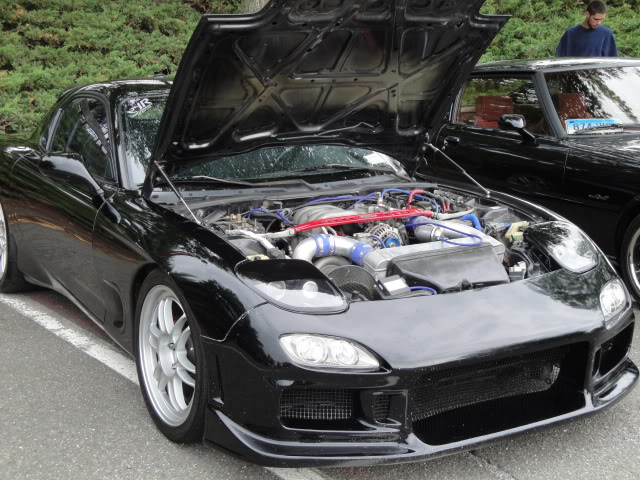

anything could be done for a price ive done a few ,was it worth it! no i came to a conclusion that my fast car would be a twin turbo rx7
and my chill car
