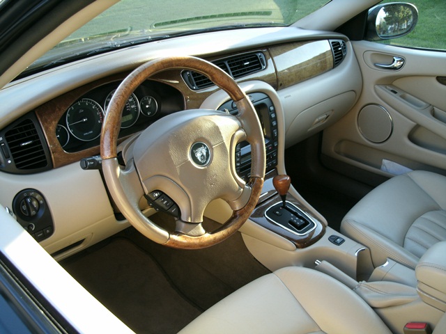

Greetings. Like "Thermo," I use Mequiar's Leather Care. I begin the process by gently brushing off the seats (dust, dirt, lint) then I actually use Turtle Wax Leather cleaner, then the Mequiar's. When I apply the Mequiar's, I do let it sit for about one minute before I gently rub it into the surface. That seems to do the trick and the cracks on my driver's seat has actually diminished. (Will that work on the wrinkles around my eyes?) Good luck!
