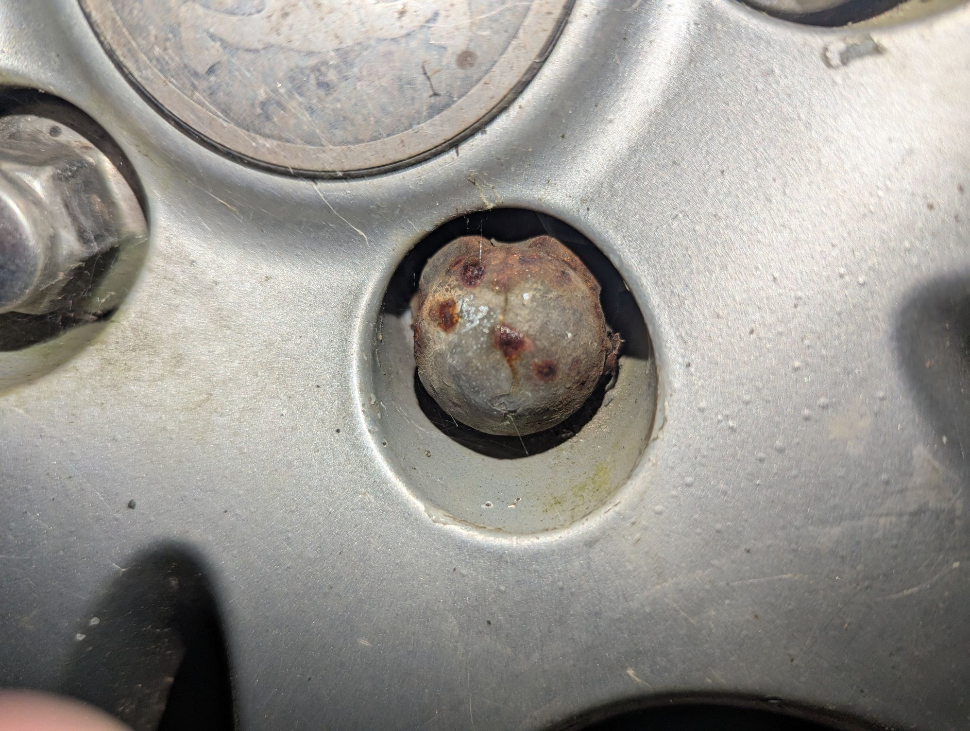

I could have been clearer, It would appear that I have the Jaguar supplied locking wheel nuts without the necessary keyed socket, did not come with the car. my fault for not checking.
I tried searching for solutions, but did not spend to long doing so I thought I'd throw it out there.
Sorry the image is so big.
Can I identify the required key number? or rust and poor quality metal might be easier to use your alternative Thermo?

PCJags, take a look at this tool kit:
YEKEPRO 15 PCS Bolt Extractor Set, 3/8" Drive Impact Bolt & Nut Remover Socket Tool Kit, Stripped For Damaged, Frozen, Studs, Rusted, Rounded-Off Bolts, Nuts & Screws, Cr-Mo Steel, T38215 - Amazon.com YEKEPRO 15 PCS Bolt Extractor Set, 3/8" Drive Impact Bolt & Nut Remover Socket Tool Kit, Stripped For Damaged, Frozen, Studs, Rusted, Rounded-Off Bolts, Nuts & Screws, Cr-Mo Steel, T38215 - Amazon.com
You will find tons of uses for this when it comes to problem nuts and bolts. Having an impact driver is going to be easier to use as you simply put the impact driver in the reverse state, apply the tool to the lugnut and push the tool into the lugnut as you depress the trigger. It will spin off in no time flat. Now, this WILL!!!!! destroy the lugnut. So, plan on having some new ones handy to replace what you remove. But then, as most will say here, upgrading to a single piece lugnut is the way to go and well worth the money spent to get them. Of note, Jaguar used an oddball thread. So, make sure you get the correct thread. Most you will find are M12x1.25. You need M12x1.5.

Yes to 1.5x12mm, plus make sure you buy the correct SHAPE of lug nut as well - there are different shapes.
Also: Apply penetration spray before attempting to remove the old nut and give it time to penetrate into the threaded area.
Nice tool-kit liked by Thermo, Maybe, I'll buy that, too.
And use reverse impact driver, yes.
I have also seen before, how a guy solved that problem at a tyre-shop before: He used a standard socket, which was just a little bit too small for the lock-nut and hammered it over the lock-nut and then used the power-tool (air powered), which they had there...

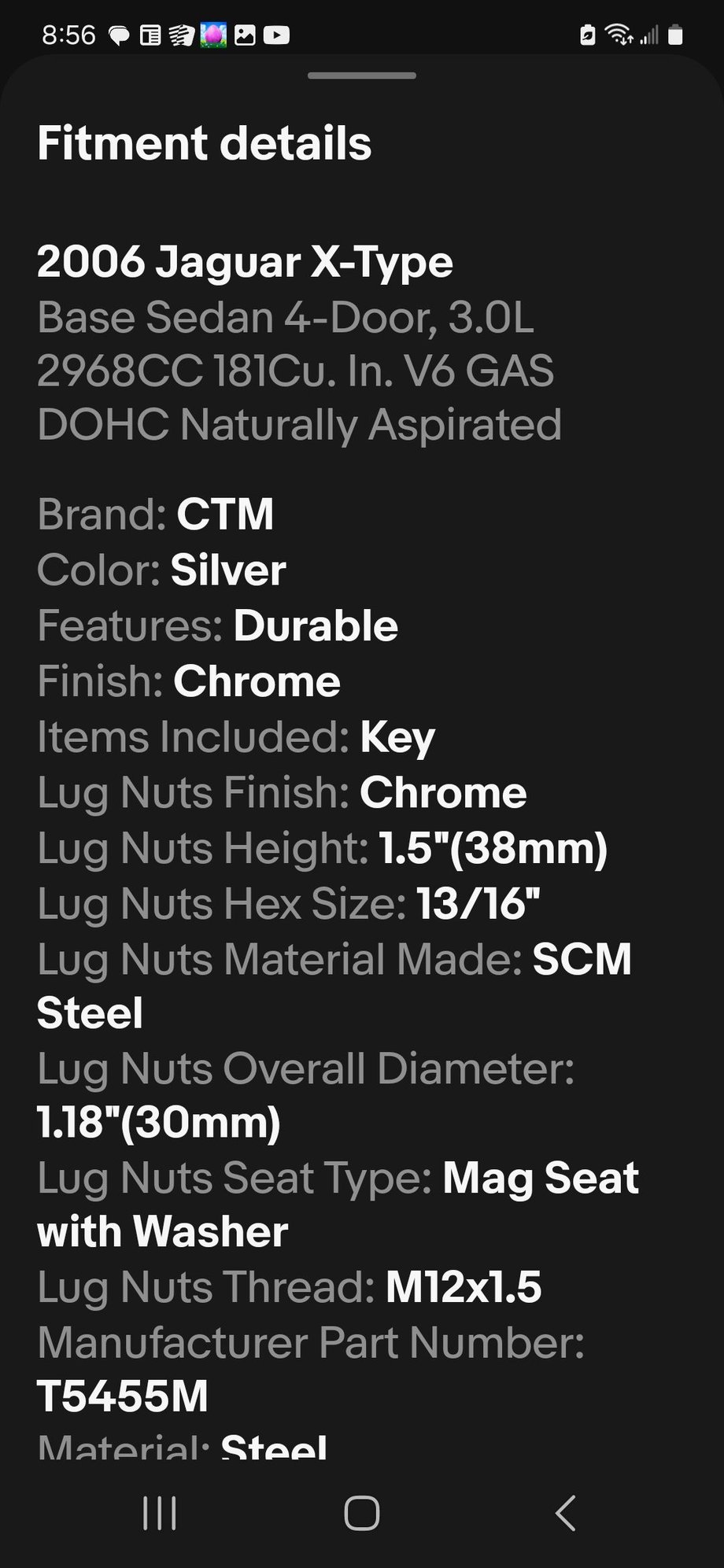

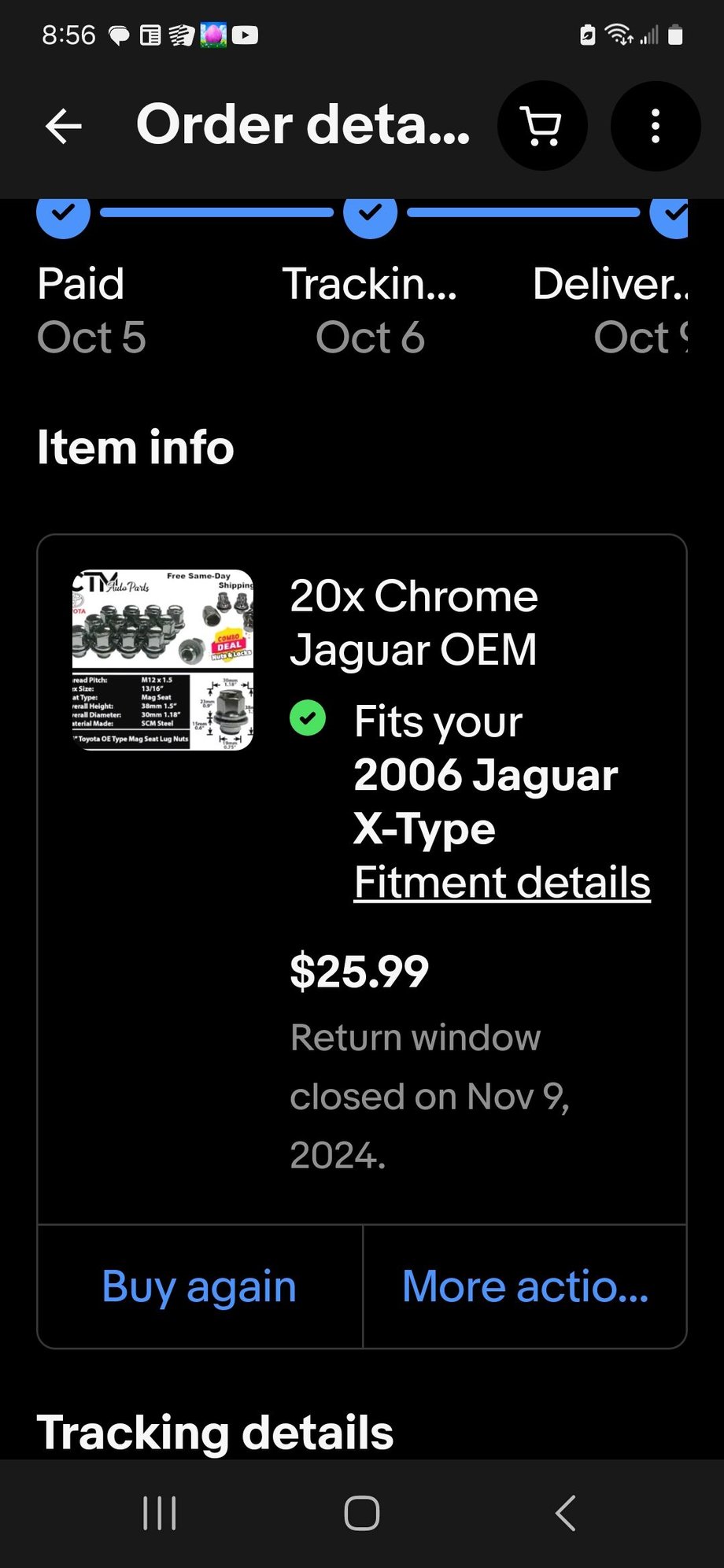

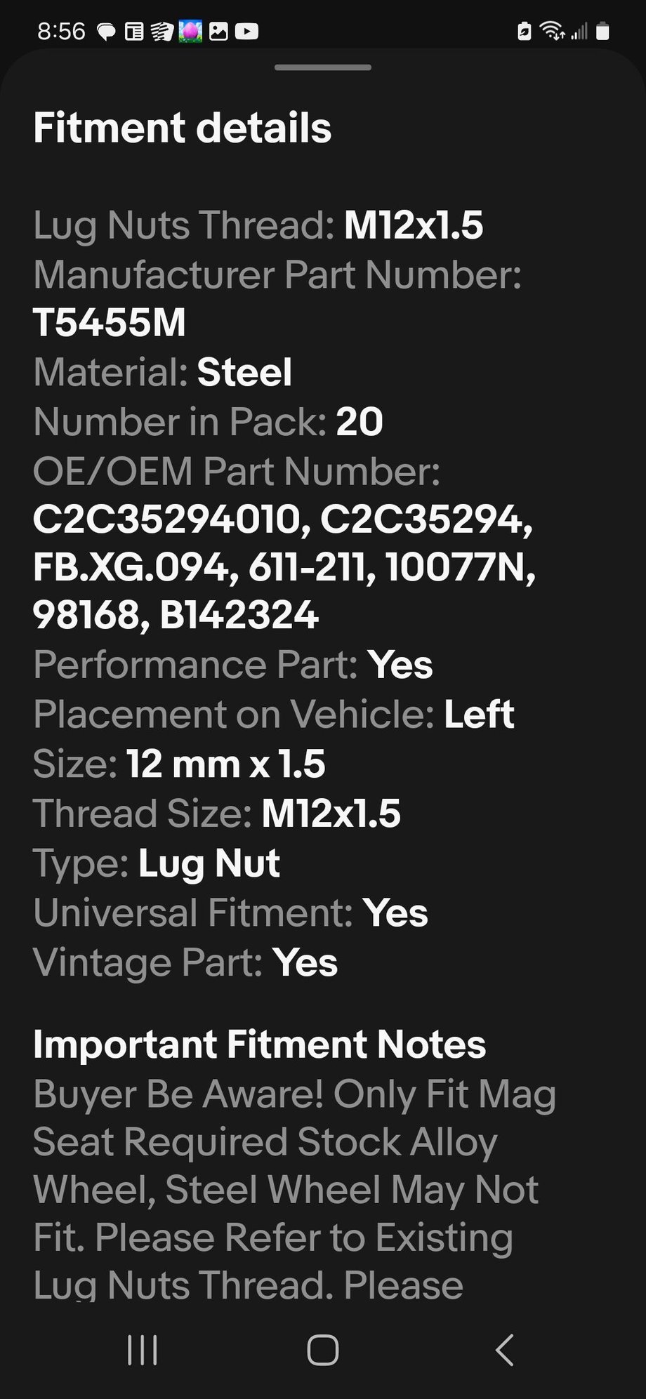

What I bought/used, they have an option that includes locking wheel nuts (4) as well.
