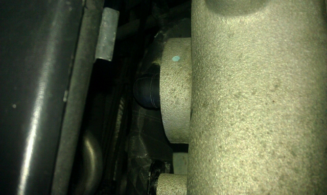

My Mech did change plugs but coil 1 went since then and his mother is in hospital so he cant work. I am missing day 3 of my job so DIY. Im stuck now though. How to remove this hose in back of manifold? Many Codes Need Help!!!!-100media_imag0491.jpg Also where is the cruise control Cable? Many Codes Need Help!!!!-100media_imag0492.jpg

This thread from the FAQs shows very well what is required to access the rear coils. https://www.jaguarforums.com/forum/x-type-14/how-tune-up-spark-plug-change-faq-48128/
There is no cable for the cruise control. As far as the rear bolt on the manifold goes, I found that reaching in from the passenger side between the IMT valves with a 1/4 drive socket allows enough room to remove the bolt. It's mostly blind but is the easiest way to get it.
