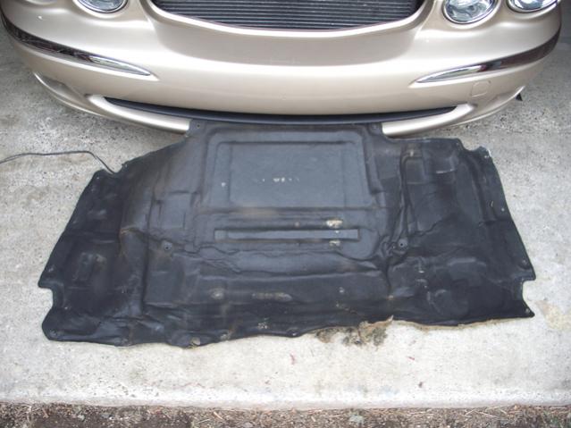

Put the X to bed for the winter. Once a week I check and start her up. Well to my surprise when I lift up the hood the other day...oh my god...big clumps of the liner insulation the size of a basketball laying on the intake...and out pops a mouse...stands up and looks at me...I can not believe it...this little pest just destroyed my underhood liner...now what?
Well after some research and a call to Gonzo Duque he had a new liner on its way....maybe it was best that the varmit chewed up my old liner...Gonzo's product was a perfect fit & definatly added attention to a normaly dull area under the hood.
P.S. that little guy is in mouse heaven now...
First time trying to post with images...hope they come out..
Comments ???

Very cool. Big difference in price between the aftermarket and Jag original part?

Around $120 and my time...about 2 hours to do it.

That's awesome, Fixit. I didn't know you could get something like that. How is that attached to the bottom of the hood?

Alfadude___
Liner is held on by 3M #80 adhesive found at Home Depot.
Replaced the original screw inserts - buttons with 1/4" rivit style from National Auto...they were a tad to long though...no problem just snipped the lenght off a hair.
I must add clearance between the liner & intake is not an issue anymore like the original was.
