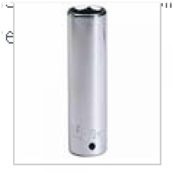

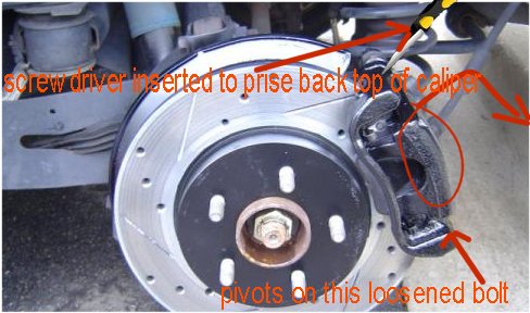

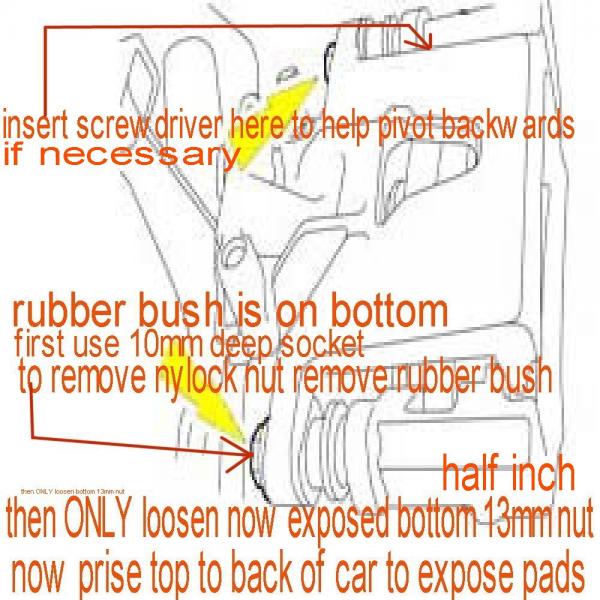

bottom with rubber bush, held in place with 10mm nylock nut.
remove this rubber bush to expose 13mm
nut in above image. You only need to
loosen exposed bottom nut and then swing
caliper down towards back of car to
expose old pads. You might need
to use a screwdriver to do this.
