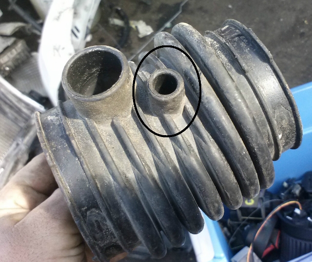

Hi, my name is Abdo. I was replacing spark plugs this morning when I was done and putting everything together I broke one plastic line that goes from somewhere under the intake to the big rubber hose that connects the air filter box and the throttle body. What is that plastic line called and if there is a part number I appreciate it. Also is it easy to replace? I really appreciate all the info and help I found in this forum ... that saved me a lot of money since i bought the X-Type for my wife couple of months ago..

The plastic pipe I'm looking to identify goes to the hole circled in this photo.

Would it be this part? 07 2007 Jaguar X-Type OES Genuine Engine Air Intake Hose W0133-1826581 for - Auto Parts Network

It just pushes in no connecters if that helps

Thanks, all for your help. It is the same part disguay mentioned but slightly different. The one he mentioned works for 2003+ models. The part for my 2002 is: W0133-1826580
I looked up online and found it on ebay for $30 shipped. Made the order and waiting for it to arrive. (Link) ... I hope it fits well.
