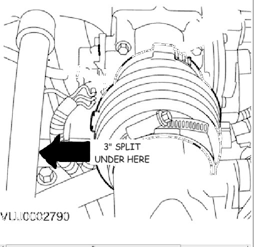

My usual answer to virtually any problem on these when they misfire...probably not this but it costs nothing to check and nothing to fix
Remove the top plastic engine cover
On the right alongside the air intake pipe that runs from the air filter to the throttle body you will see a pipe like this
These commonly split and cause misfiring/poor mpg cut out at 3000rpm
If its damaged you can tape it up until you get a new one.
My dealer sells loads and they are only around GB£5 ($8??)
Good luck if it aint that
