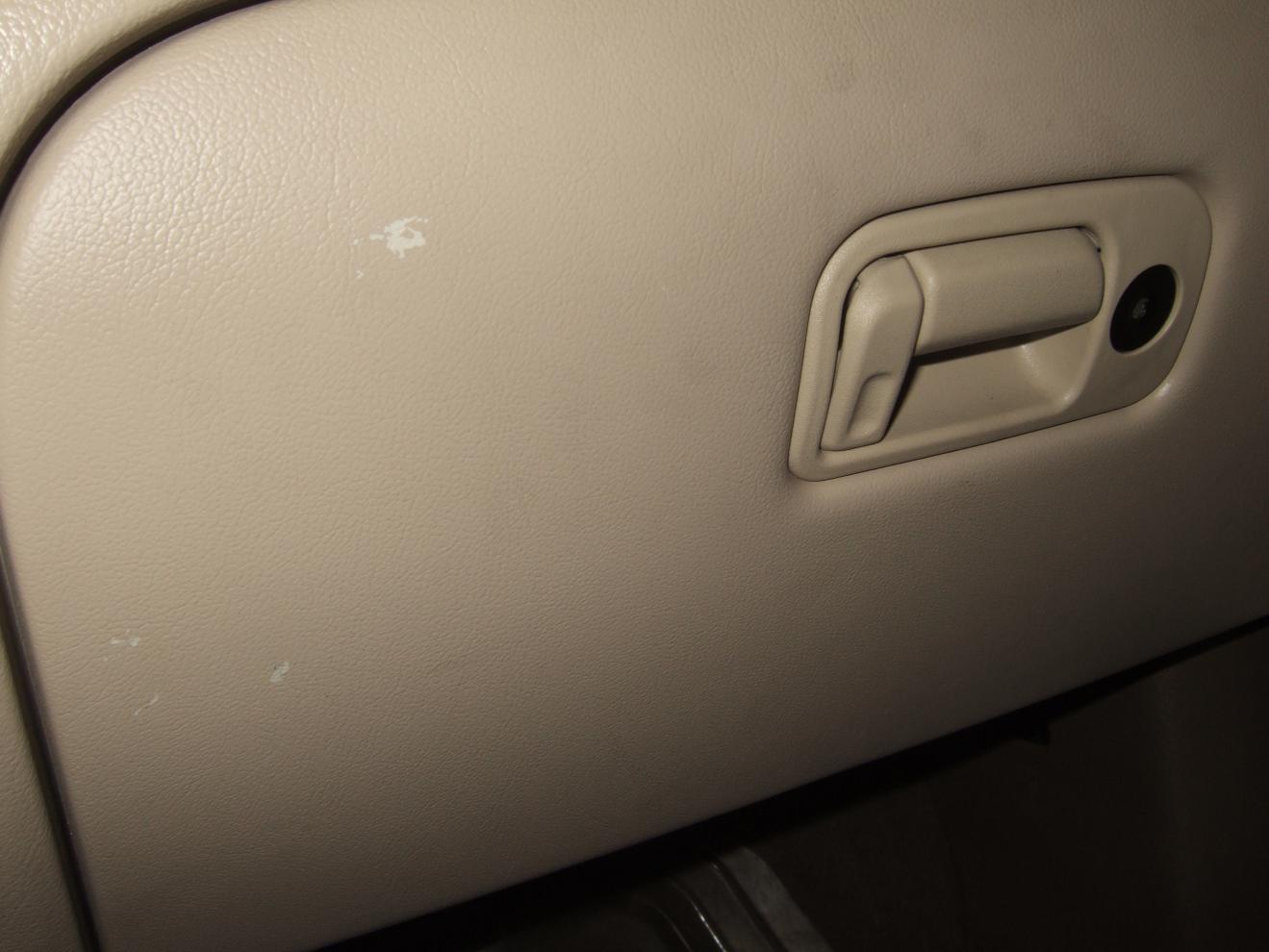

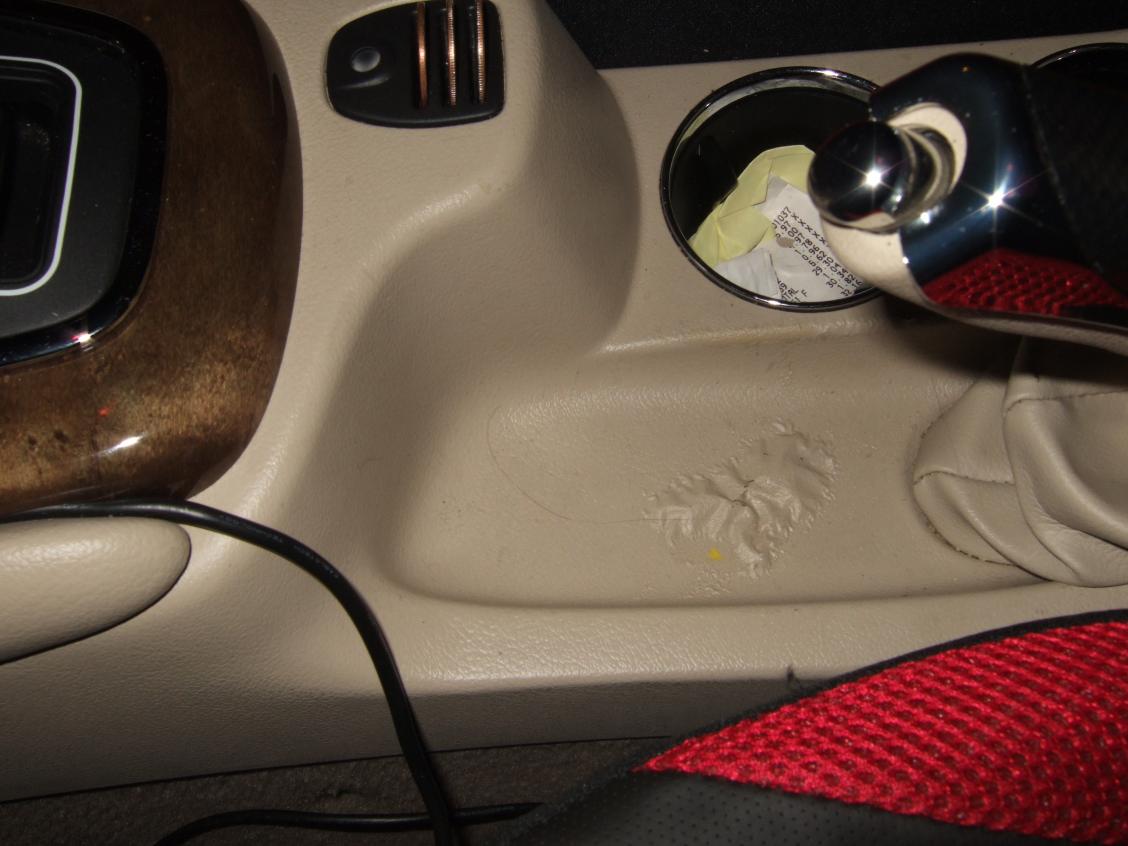

Please guys, I need some opinion and some help on how to fix this (pictures).

The glove box is going to be pretty easy. All that is needed is to get some paint that matches the interior of your vehicle (can be picked up at automotive paint shops, not your neighborhood auto parts store) and then you pull the glove box off and paint it. I would recommend using an air brush as that will apply a much thinner coat of paint and it will keep the texture of the glove box present. you will need to walk into the paint store with your interior color code. Look in the driver's door jam and you will find the 2-3 character code for the interior (INT CLR as I recall, the code will be directly under it). That tells the paint shop exactly what tints need to go into the paint. Stand by for a hefty price though. The last time I was quoted a price, it was like $100 for a pint can. But the pint can is enough to do pretty much the entire interior of your car.
As for the center console piece, talk with an interior place. They should be able to hook you up. I'm sure they have the necessary stuff to fix something like that. What it will cost, I have no idea.

Man, what spilled in that center console? Something you might be able to do is find a piece of rubber and cut in the shape of that area and cover it up. They sell stuff for like on the dash so things don't slide off. Might be a cheap and quick way to hide it and still look good.

Can you flake off that bulging paint on the console? If so, you may be able to just sponge a couple layers of matched up paint once that is off. Same with the glove box. There's a guy on ebay that I purchased interior paint from, he matched up the interior code for mine (Ivory), and it was an almost perfect match for the seats and you can also use it on interior.

and I did not spill anything. That is from that DESODORANTE like a tree, I just left there and forgot for that peace of s*** after a couple days I was cleaning my car and I decided to throw that in the garbage. When I picked that up from the middle console, I saw that freaken bulge. Think from maybe 35c made some damage on my kitty.
