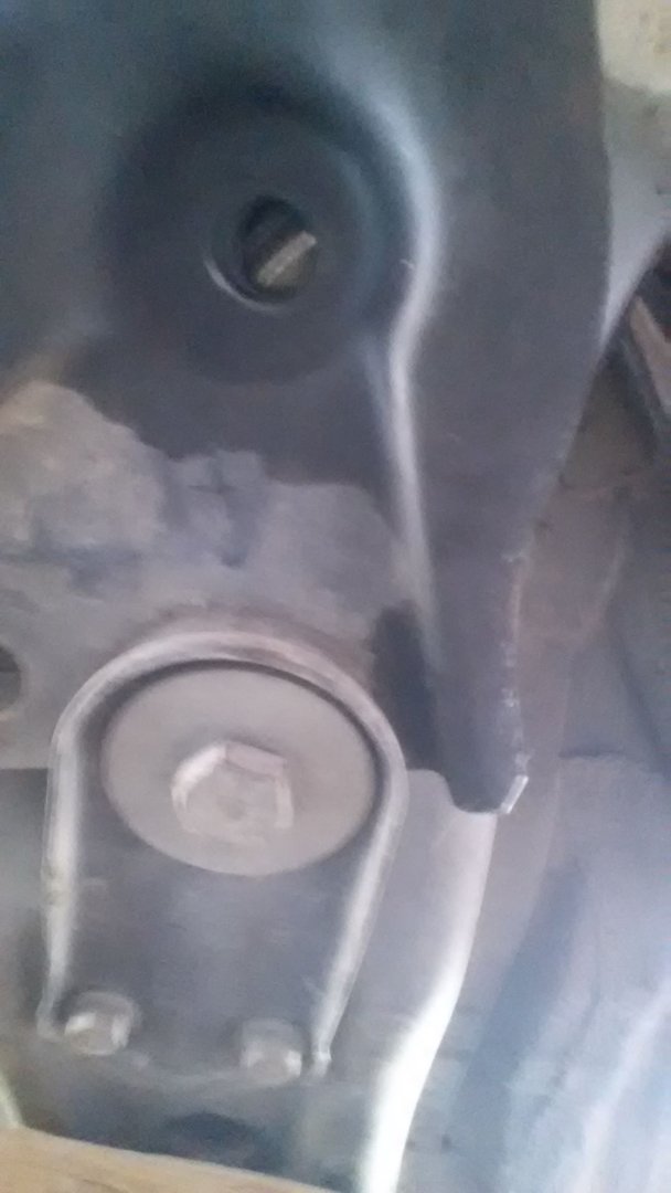

So...things were crazy at first but I got thru a lot of the other stuff...but now that I'm almost done the last rear bolt in the control arm won't slip out the vertical one. I know the instructions say to loosen the the sub frame. Things I've never done that in any car. I see three bolts and the instructions say do not remove completely..so here's a pic, do I loosen all three and how long are the bolts so I don't accidentally pull it all out or is this even the right bolts..lol

The do not remove is a caution to not completely remove until it is braced (see video).

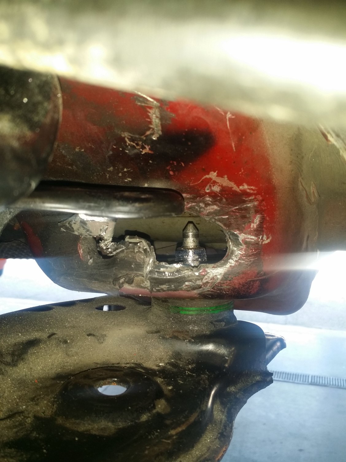

This video is spot on for the Jaguar X Type. The caution (& problem if it happens) is the 21mm bolt can "strip" the captive nut that is supposed to hold it, mine did. I took drastic measures to get it out. I'll post a pic. Afterward another member posted a way to access the "captive nut" by cutting a small access hole in the interior floorboard. Wish I had seen it, lol.

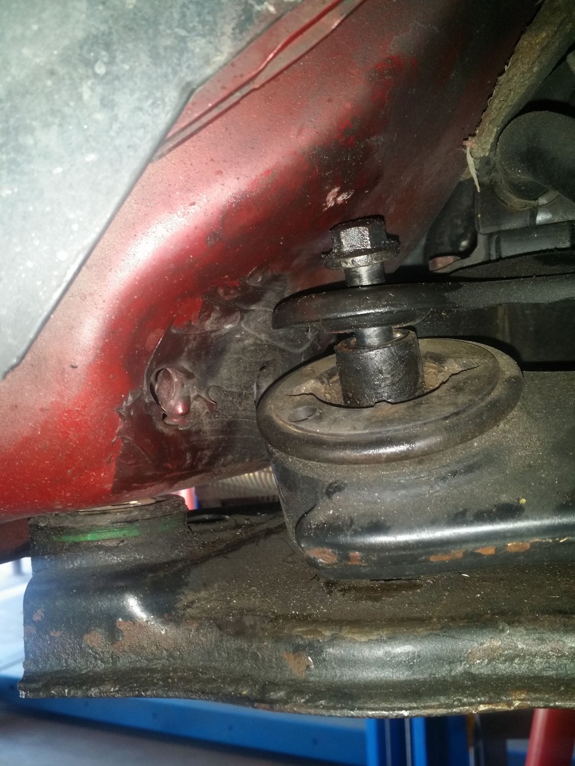

Also, as per learning from another member, reverse the rearward bolt on the arm so that the nut is on the top. This eliminates the need to drop the subframe in the future if ever needed again.
This bolt, reverse =
My mess to access the "stripped" nut =
