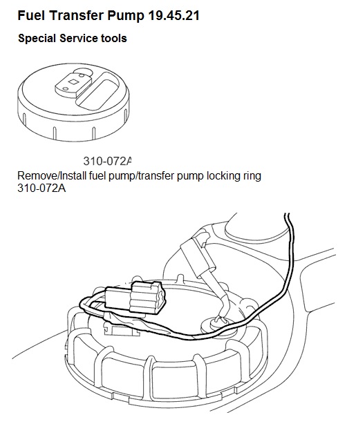

This drawing of the Service Tool 310-072A and the pump retaining ring may prompt some suggestions for an alternative removal method:
How to approach this depends on whether it just rotates to release or has to be depressed and rotated at the same time.

As for your problem. I have had to remove that ring off of a few other vehicles. What I use is a square piece of wood (I found the wood handle to a small wire brush seems to work great) and a small hammer. From there, you put the wood perpendicular to the ring at one of the notches and tap on the wood and the ring will work its way off. Don't go King Kong on it, but you will find that after a few taps that move the ring, it will spin right off using your hand. You do the same thing when putting it on. Spin it on by hand and then use the wood to tap the ring into place. You will hear the sound change as the ring gets tight. Stop. Else you risk damaging the ring as you can only hit it but so hard.

Thermo, I finally made it and replace my fuel pump and now my cat is running again. I followed your adviced but its to hard to move the lock. Then Jaguar tech here in San Diego gave me a tip how to unlock the fuel pump if I dont have the special tools. All I did is spray wd 40 on hole on top of the lock ring and let it soak for at least 5minutes so it can lubricate the oring or seal. Then I used a very dull chisel and rubber hammer and tap the side of the lock ring gently. All you need is one tap and the ring loosen up. Wow that was so easy. No need to buy the $200 plus special tools. Fuel pump changing is really a challenge, theres a lot of parts need to be move out before you can take out the gas tank. I will write it down in my next thread so people can do it by themselves.
