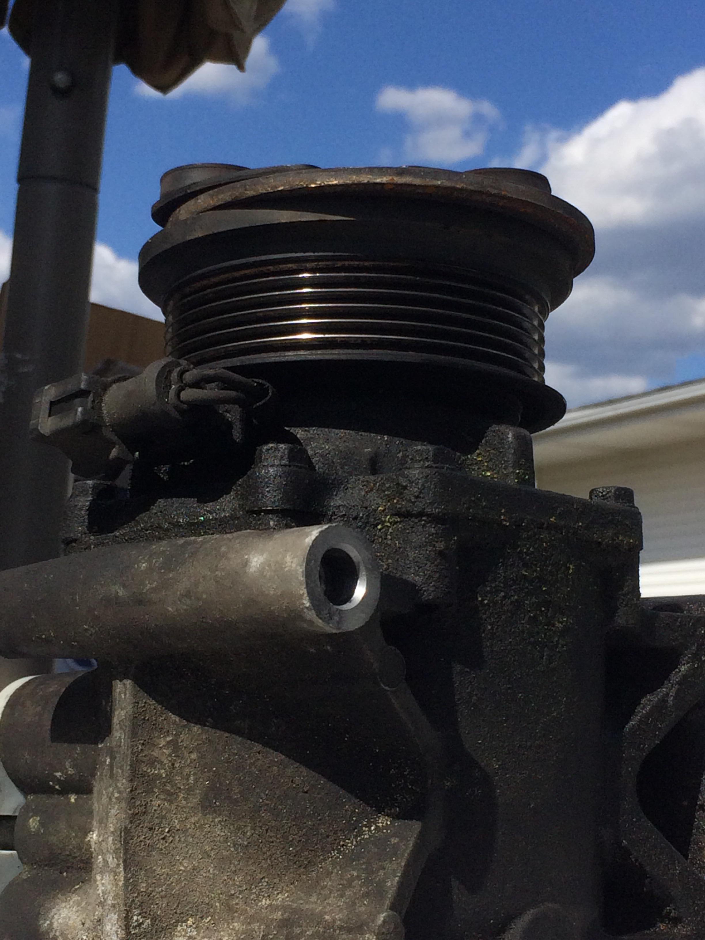

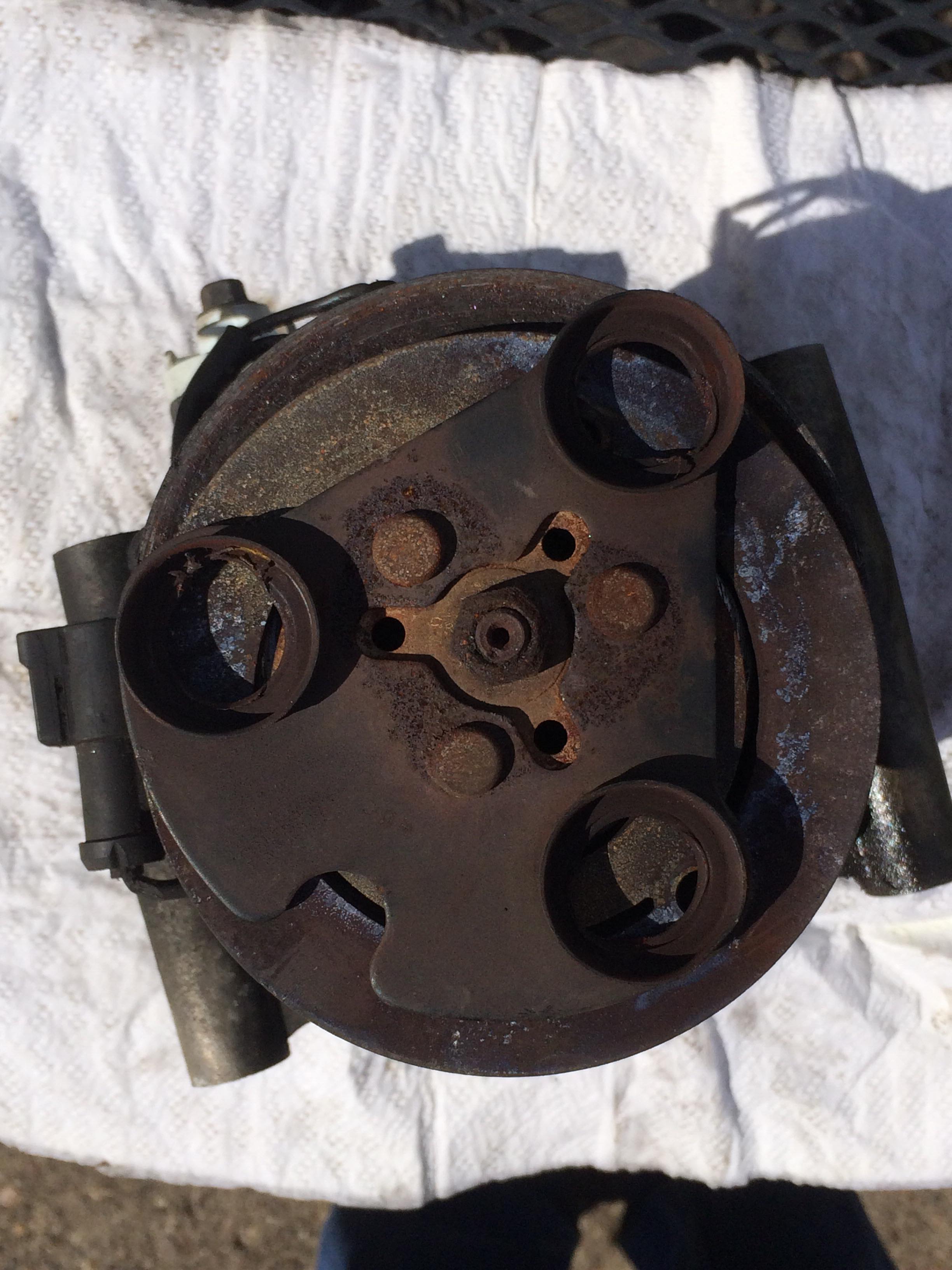

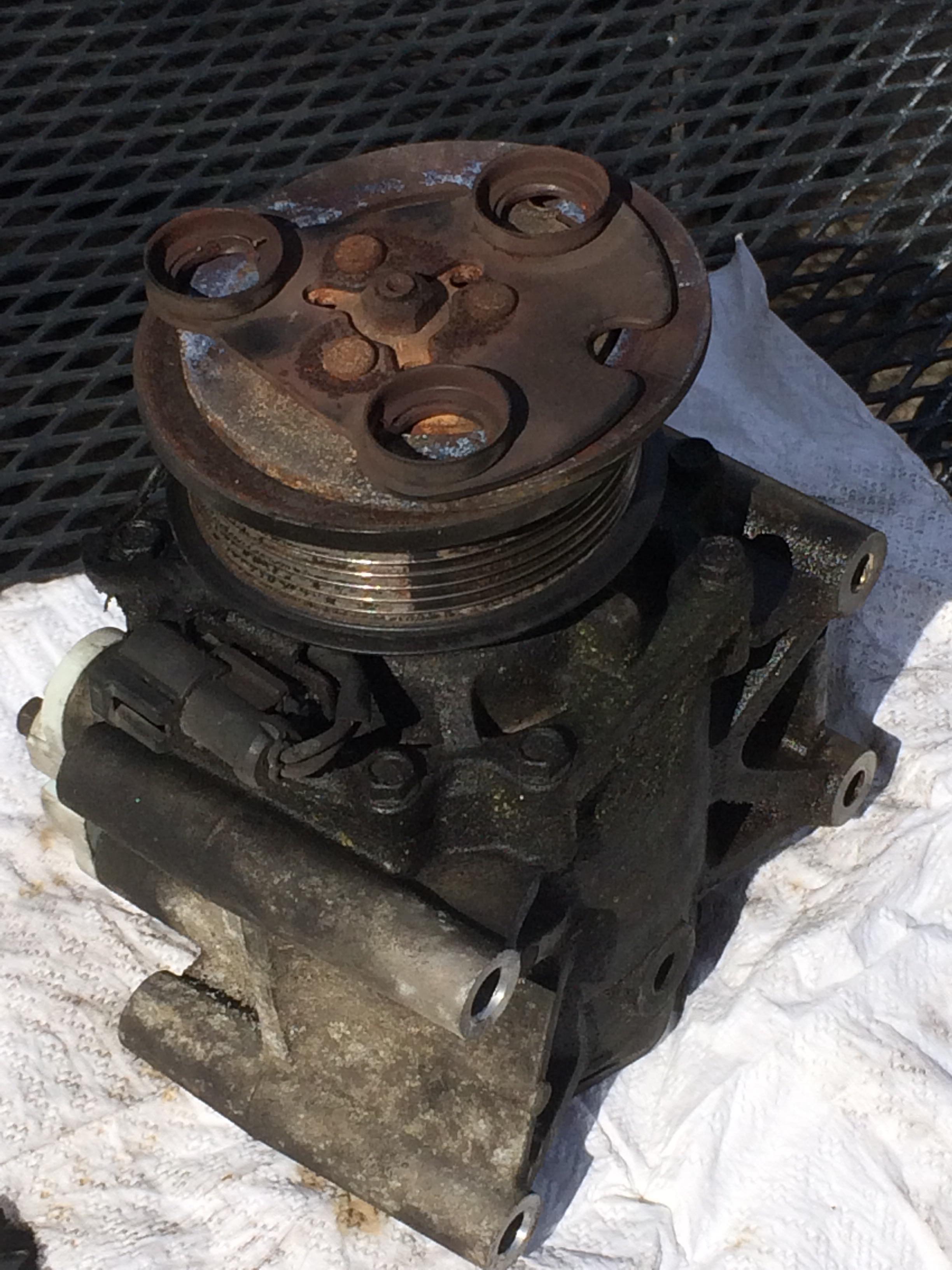

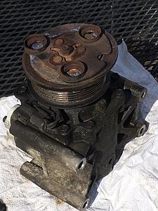

As I'm looking under the hood, I notice something funny looking about the AC clutch. It's got the friction portion rotating quite a bit off center. I only had a short window before the winter weather blew back in, so I didn't disassemble anything. I am hoping this will wind up being my vibration. I didn't have time to pull the serpentine belt to see if the vibration persisted without the ac spinning. More on this later.
Smooth as glass now. It was the AC compressor clutch. It had partially come apart, and as the images(If they uploaded correctly) show, there was a lot of mass rotating off center. I put the new compressor on and that was it, almost.
