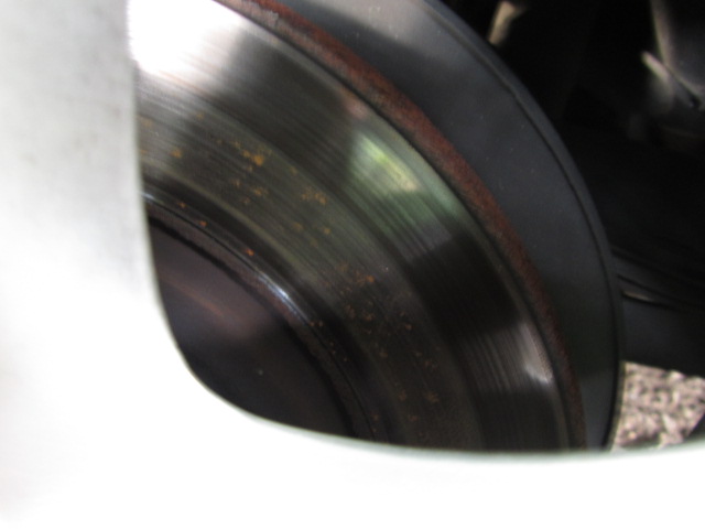

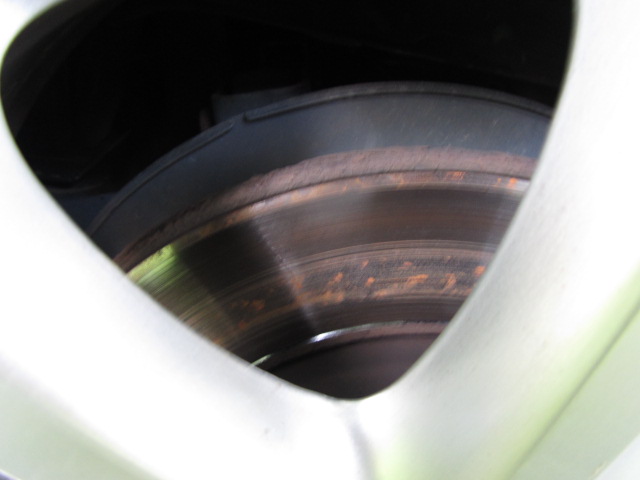

After replacing the front/rear pads over the weekend all went well.
So today i drove the 200 miles to work and when i got here i noticed a wide line of surface rust on both rear rotors, it looks like the pads are only contacting 50% of the rotor. The brakes work fine (it seems)
Could that be because of the weird angle the wheel are sitting at due to the dead rear control arm bushings?
The old pads showed no unusual wear patterns, nice and even.
i attached pics to show

read elsewhere its just part of the bedding in process
It looks like you only replaced the pads. The old pads wore with the rotor, so they sat flush to the surface, following all of the ridges, bumps, valleys.... you get the idea. You put new pads on, that have no wear pattern at all, so they are only catching the high surface of the rotor. It may work itself out, but not without it's problems (noise, vibrations...)
This is why I always replace pads and rotors as a set, or at a minimum get the rotors cut.
If this is only happening in the rear consider yourself lucky. I would remove the rotors, and get them cut, and sand the pads down till all of the "wear" is removed.
