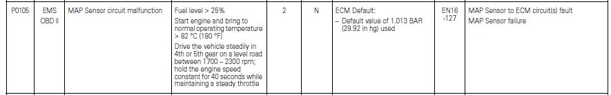

The code indicates a bad MAP sensor or a bad wire between the sensor and the ECM. See the attached info. I would first check the wires but most likely the sensor is bad.
Attached Thumbnails ODB fault code P0105 Manifold Absolute Pressure sensor-map-sensor.jpg   ODB fault code P0105 Manifold Absolute Pressure sensor-map-sng.jpg
