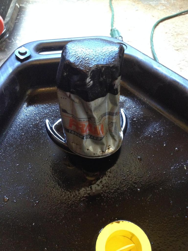

Oil changes are good but one word of advice or caution, I would NOT use FRAM filters, reason: The ends of the filter paper inside are GLUED and not crimped and they have been known to come apart inside then they don't filter and you can't tell and 2nd they don't have a check valve in them so the oil drains out during shut down. Spend an extra buck and get a Bosch or even a Wix.

Actually it's not the filters fault but it's whoever installed it. I went to change the oil on our recently aquired x-type and the previous owner had a Fram filter on it. I thought oil changes are easy. The first part was, remove the drain plug and drain the oil. The second part was a pain because the filter was on so tight the only way I could get it undone was to use a webbing style filter wrench that connects to a 1/2" drive ratchet. Well it's now done and filled with Castrol Edge and a new Motorcraft filter.
