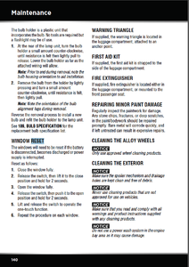

Due to a battery malfunction my drivers widow has lost the "up" single touch function. Down is still OK.
I know I have seen the reset somewhere but cant find it now.
Suggestions please.

Stolen from an earlier post on this forum:
Enjoy!

Thank you for that. It works!
I knew I had read it somewhere, just couldn't find it.
