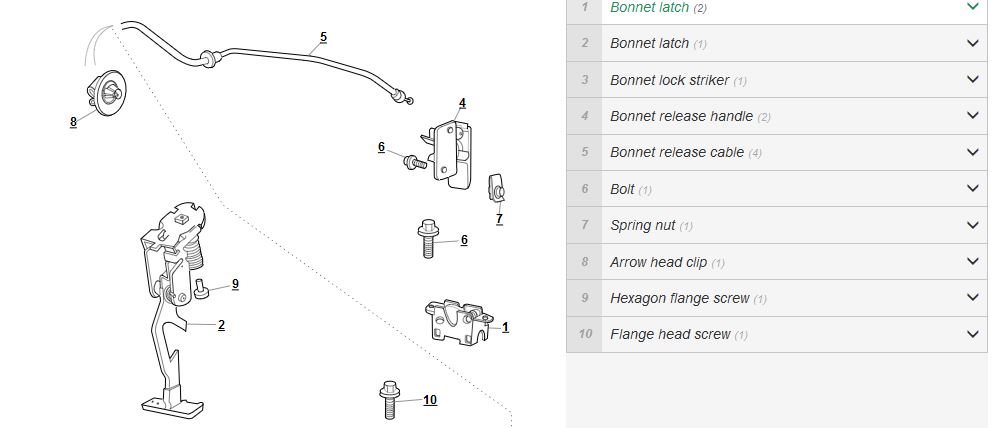

To be of help we will need a little bit more information. You state only one latch will release. Which one is releasing?
When you pull the handle in the passenger compartment does the bonnet pop up?
If it pops up can you feel and move the secondary latch?
I have attached a parts blow up of the bonnet latches. Latch 1 is cable operated from the cabin and latch 2 is reached from behind the grill.

Sorry buddy I should of said the passenger side pops up but the driver seams to be seized shut has a previous problem on same side a couple of years ago with it not locking so I lubricated but obviously not enough lol
