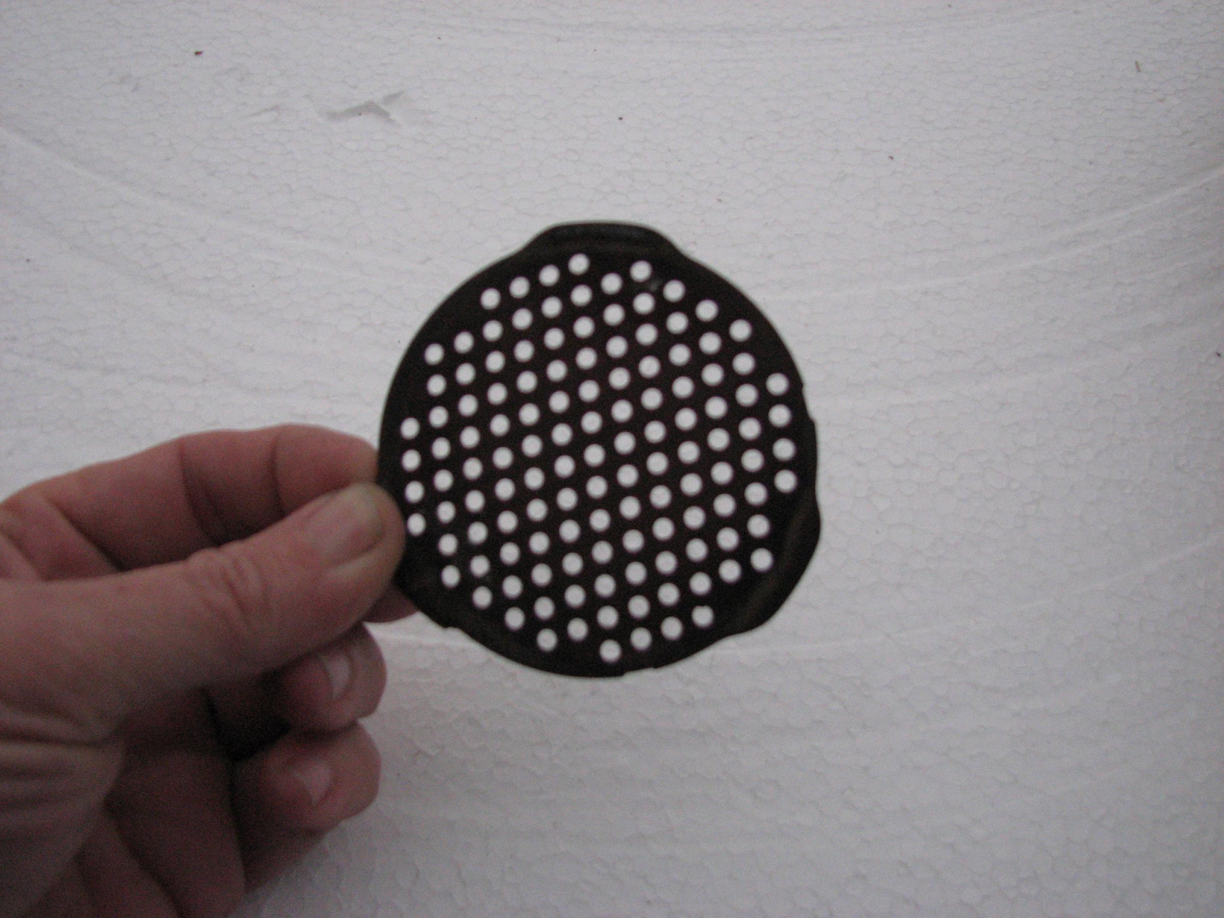

Anyone know just what those removable metal "oversize pepper shaker" disks located between the exhaust manifold and the catalytic converters are for? They look like small flat 2 1/2 to 3 inch diameter manhole covers with holes in them. I imagine they are there to prevent the converter from becoming clogged or contaminated but smaller carbonized fragments can still get through the holes anyway. I can't imagine large chunks flying out of the exhaust ports that would need to be broken up. It appears that perhaps 40 to 50 percent of flow is blocked by them.
It seems that removing them both would result in more power due to a less restrictive or congested exhaust stream. Has anyone does this and if so was there any noticeable change?

I've got the 2.5 gas engine, a 2002, automatic. Topaz like you wife's car.

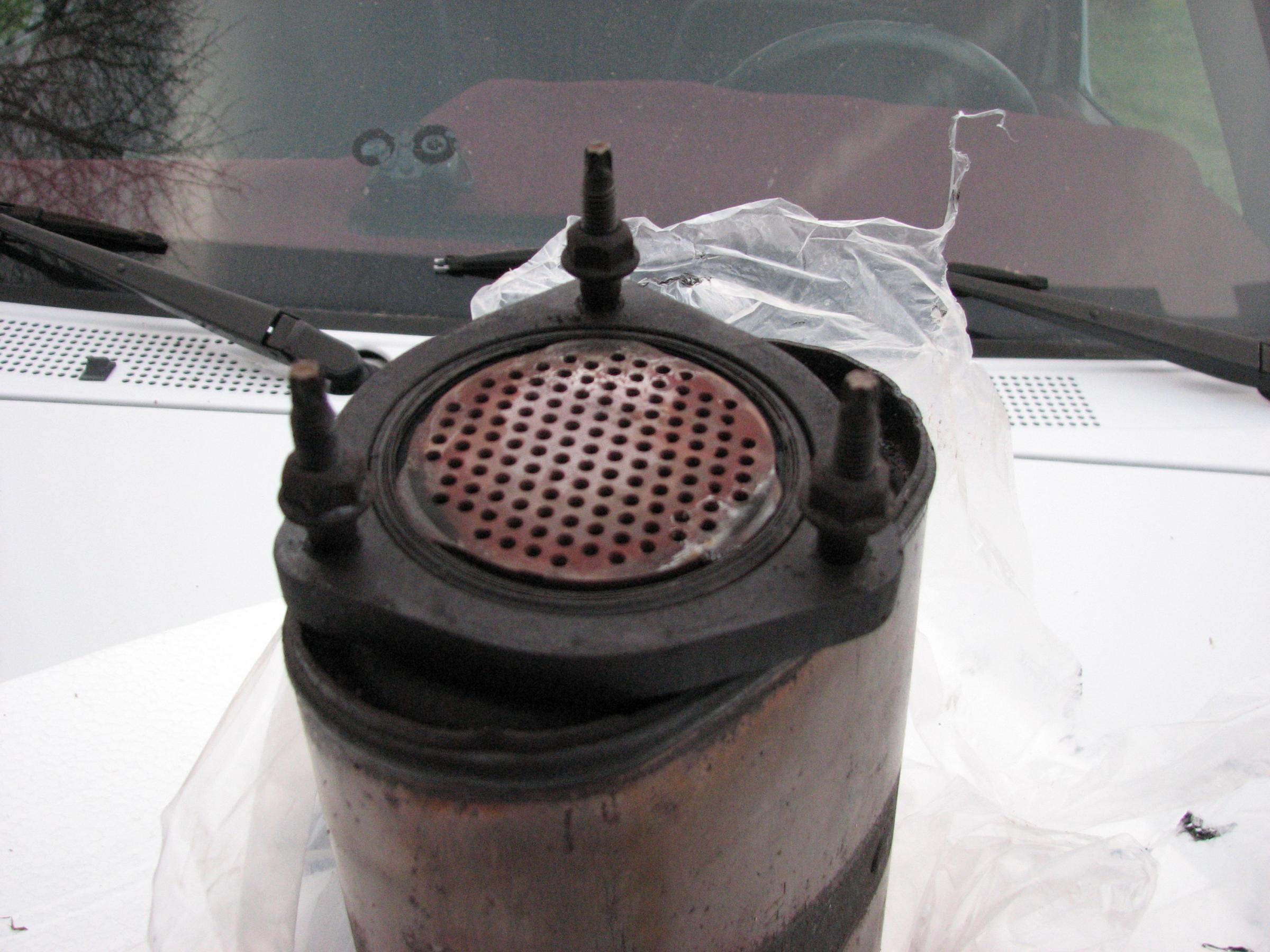

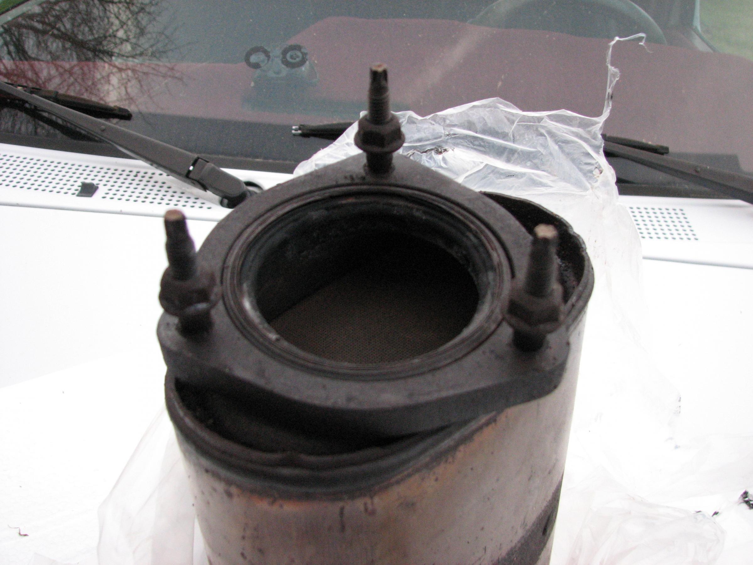

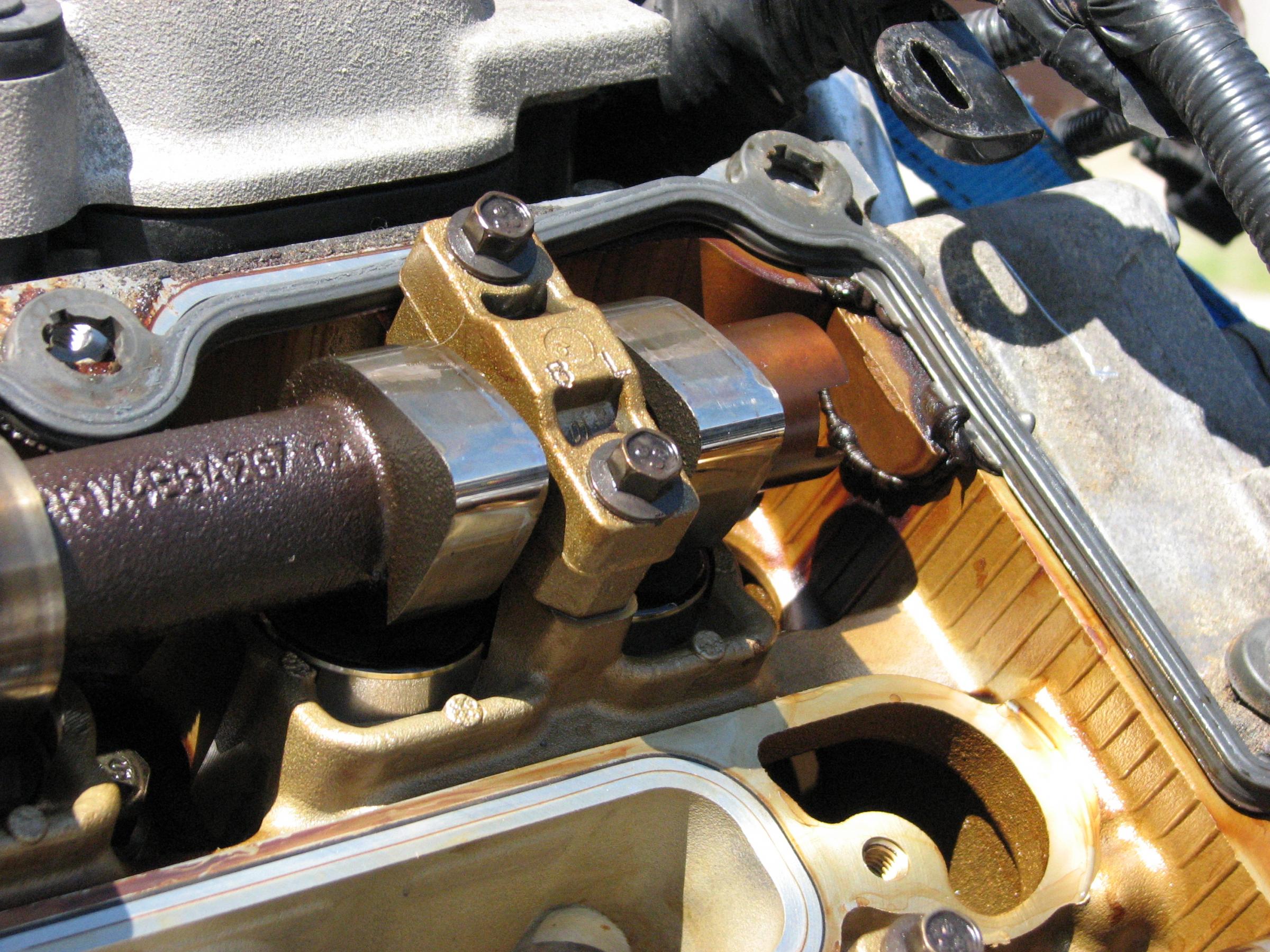

My four photos show it laying on styrofoam, held in my left hand, in place in top of the converter inlet, and the converter without it in place. (Also a couple of shots of my pretty clean engine. The shot of one cam shows how clean full synthetic oil has kept it inside, no sludge.)
All exhaust flow must pass through these disks to get into the catalytic converters, they fit very closely matching a same-height indentation in the inlet. You can see the edge on the indention that holds it in place in the last photo, the inner-most ring. They are sandwiched in between the converters and their exhaust manifold.
They don't appear to form a seal and looks like taking them out wouldn't create a leak. Perhaps they merely prevent hot spots in the converter "matrix", evenly distributing hot gasses entering into the converters? Maybe there to keep a backfire/misfire from pounding the converter innards?

Ouch! Holy crap, bro. That's malfeasance.
Anyway to your pepper Shakers... mine didn't have those. Those only look useful for causing rattling noises.
