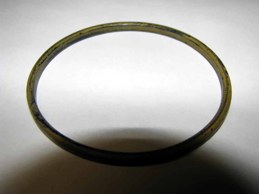

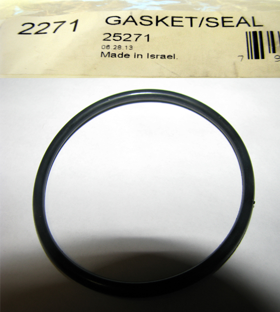

i just fixed this same stuff today. 26$ in parts and 10 minutes and it was done. mine was 8mm bolts on the IMT ring replacement. you dont have to get the genuine part they didnt have the part listed in other post but was able to find a 3.5mm thick set and it worked great. for 6$ i got 4 of them so i have 2 spares.
the lower o ring was just as easy just unbolt and turn the unit 1/3 turn and then pop it over the edge of the manifold. didnt have to losen or take anything off for those other than the IMT VALVE. dont pull upword while popping over the edge or you may damage the flap actuator thing.

the parts store didnt have the replacement. but they went back and found one that worked very well. nice tight fit and a little thicker than the original which makes for good fit in engine also. it looks to be for a coolant thermostat or something so it should be good with heat.
