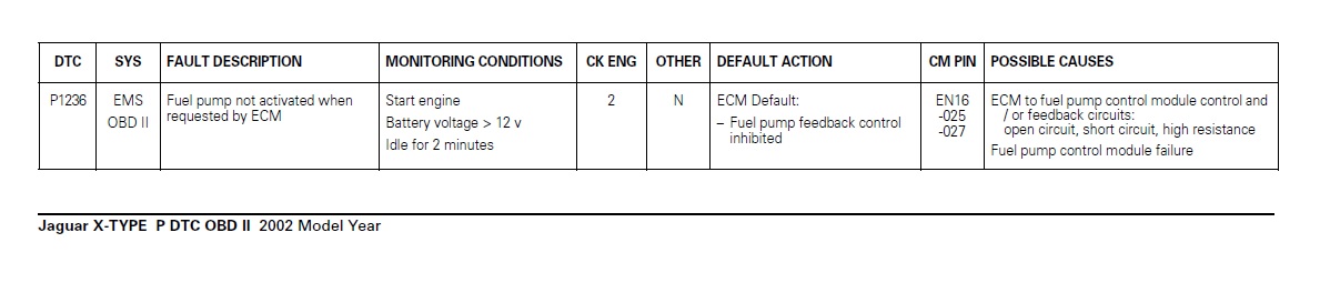

Kris,
The Jaguar DTC listing for P1236 is:
The 'possible causes' shows either the Fuel Pump Control Module itself or a fault in the harness connection to the ECU.
The fuel pump is located inside the fuel tank. The fuel pump module features an integral fuel tank sender unit and is fixed to the fuel tank by means of a locking ring. As the fuel tank is of a saddle design, a fuel pump module and a transfer pump module are incorporated. The fuel pump module, located in the right-hand saddle, transfers high pressure fuel (low flow) to the left-hand side of the fuel tank. The transfer pump module, located in the left-hand saddle, then transfers low pressure fuel (high flow) into the right-hand fuel pump.
