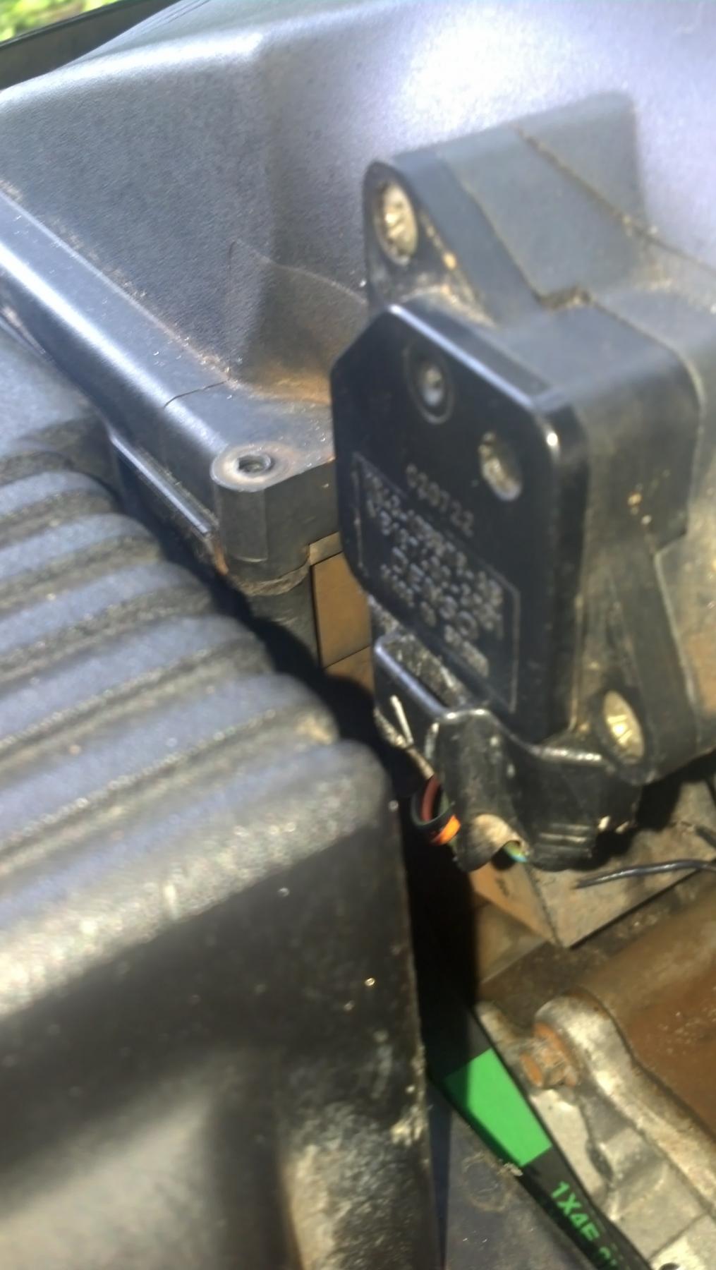

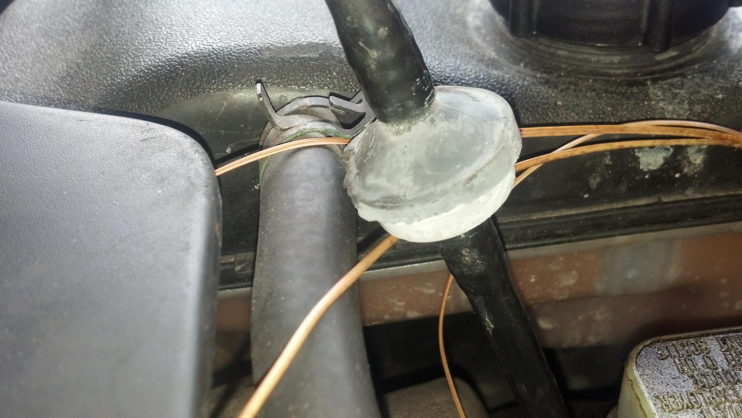

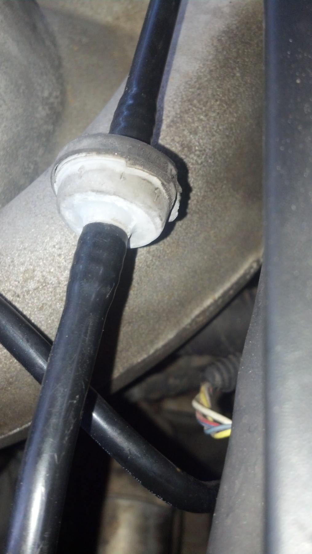

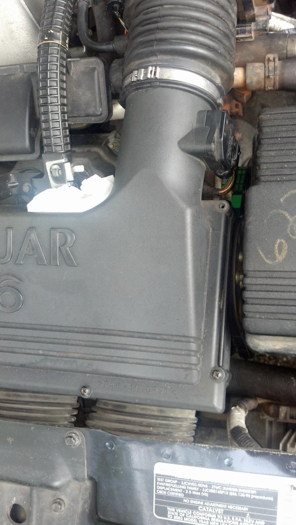

here are some pic's of brake booster and filter..... I have kept it in well condition compared to previous owners (only two other owners both women... lol) I think it may be the intake filter box leaking (right corner is completely stripped out does not torque down at all) and the brake booster but you all let me know what you think...
it has been a long process...

That thing looks like it is cracked/chipped off on that one side. From your codes you have a vacuum leak and that definitely looks like a good candidate of the cause if that is cracked. Is there some way you could maybe wrap that in duct or electrical tape to somehow seal it off and then see what you have? Hard to tell exactly from the picture, but that thing doesn't look completely smooth and round.

don't judge me... but I tried blowing into the tube or even sucking threw it like a straw and nothing just like its blocked off.. but I will tape it up today and see if there is any difference... will my intake box not being screwed down all the way cause problem im experiencing??

I wouldn't think so because it is upstream of the MAF, but I am not 100% sure. I'm sure someone much more knowledgeable than me can chime in on that. But I would think it would be similar to a cold air intake. But, if you just feel more comfortable, you can always tape that corner of the air box up real good to seal it up. You have a leak somewhere, just need to find it. The little money I have I would bet on that valve.

Unseen, if you are trying to blow threw it and sucking through it from the same end, then your braking issue may be because of that check valve. In short, it is not allowing the vacuum from the intake to assist with the brakes, making them feel very firm.
As for the air box, it really is not much of a problem as the MAF is still down stream of that location, so, the car is not going to car how the air gets in the tube as long is it is seen by the MAF sensor.
The other thing that I would check is the flexible tube that is between the MAF Sensor and the throttlebody. See if you managed to somehow get a small rip/tear/hole in that and it is causing all your issues. Also make sure the piece is firmly seated on both the throttlebody and the MAF sensor tube. How does the wiring to the MAF sensor look? I have heard of people have issues with that wiring too.
