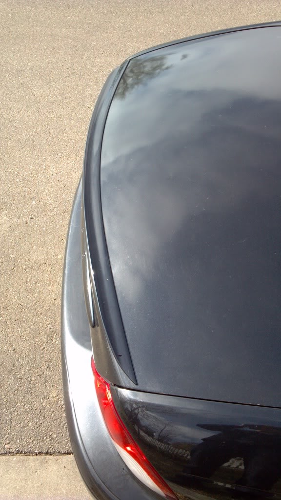

So my old and I think stock replica spoiler was cracked in the center and pitted. The color didn't even match (flat black vs my metallic black) so I decided to look for a new one. I know some members have beat around the bush on this topic and were hesitant to waste $40 on a spoiler because it might not be the right size or color. Anyways, I hope to clear this up and help people make their car a little bit better.

The thing about this spoiler is that it is painted and shipped in a straight box so the spoiler doesn't originally fit the contour of the trunk. With that being said, the spoiler is very bendy and malleable, so I set it between a couple ski boots and the wall for a day or two to get the spoiler to be the right contour. Also, this spoiler attaches via adhesive so it's really one shot to get it right. What I did, and it worked very well, was to first put the spoiler in the right position without peeling the adhesive. Then I marked the sides of the spoiler with masking tape so I would know where to place the spoiler once the adhesive was peeled off.

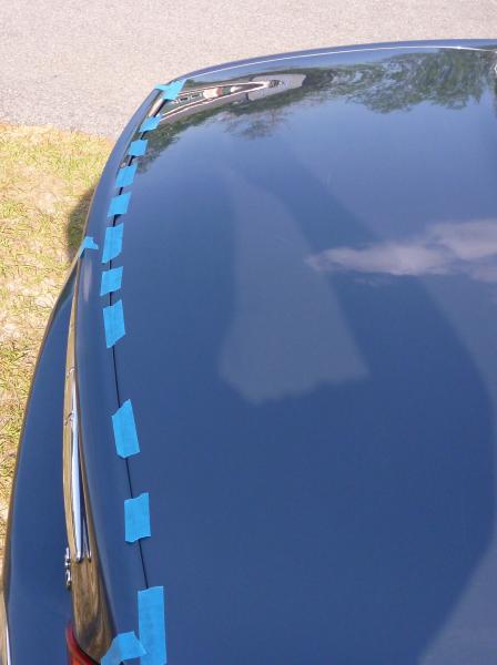

I took mine straight out of the box and laid it on the trunk, it was out of sorts side to side & front to back.
It's sunny & warm so it's taped to the trunk right now, my hope is that it will conform in an hour or two
Just went out to look after one hour, still fightin me...

Waited another hour and was rewarded for my patience... By now the Spoiler was malleable enough to attach.
The cool thing is my wing came with two thin strips of foam tape so with the aide of my wife we started at one end, pulling the tape backing at right angles to the spoiler til we got to the next piece of blue tape, peeled that up, then on to the next. very methodical and pretty foolproof
