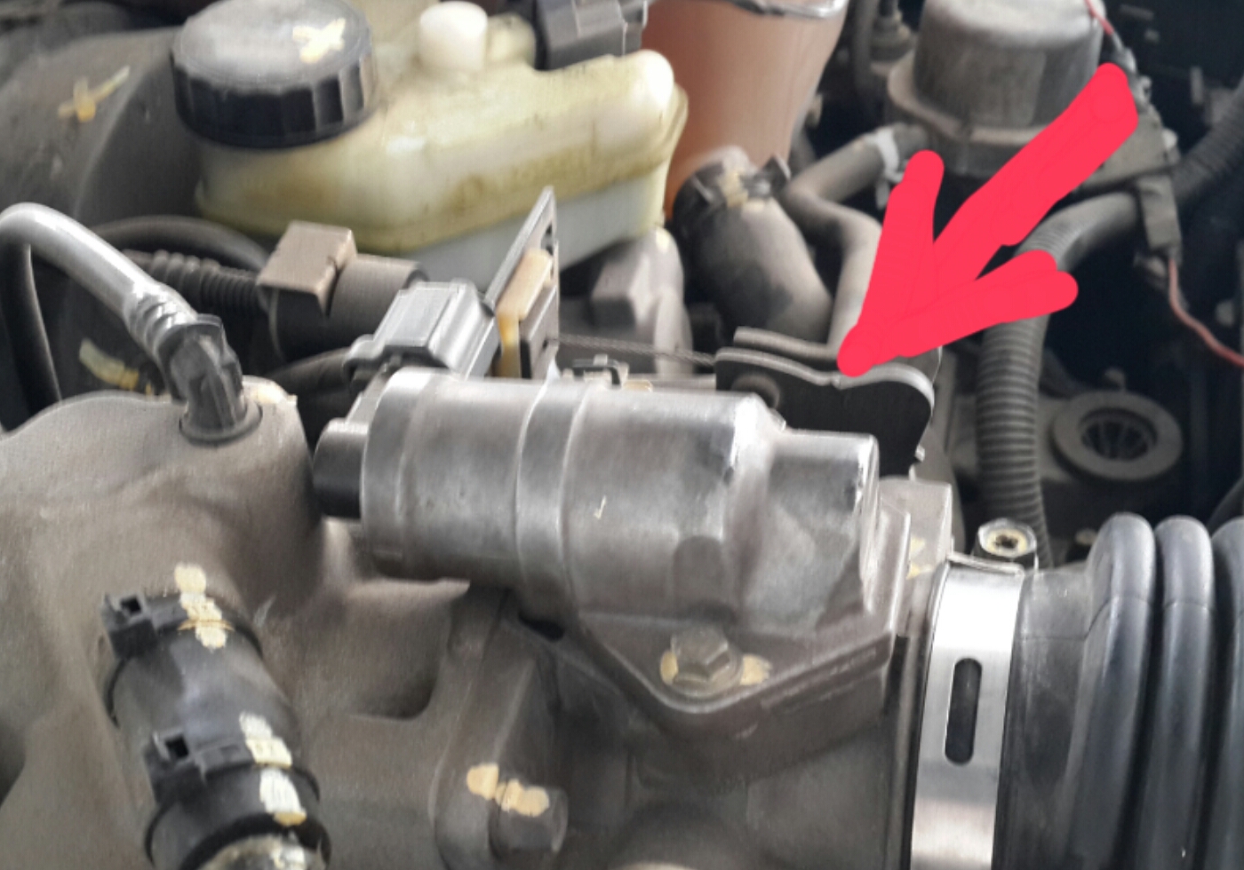

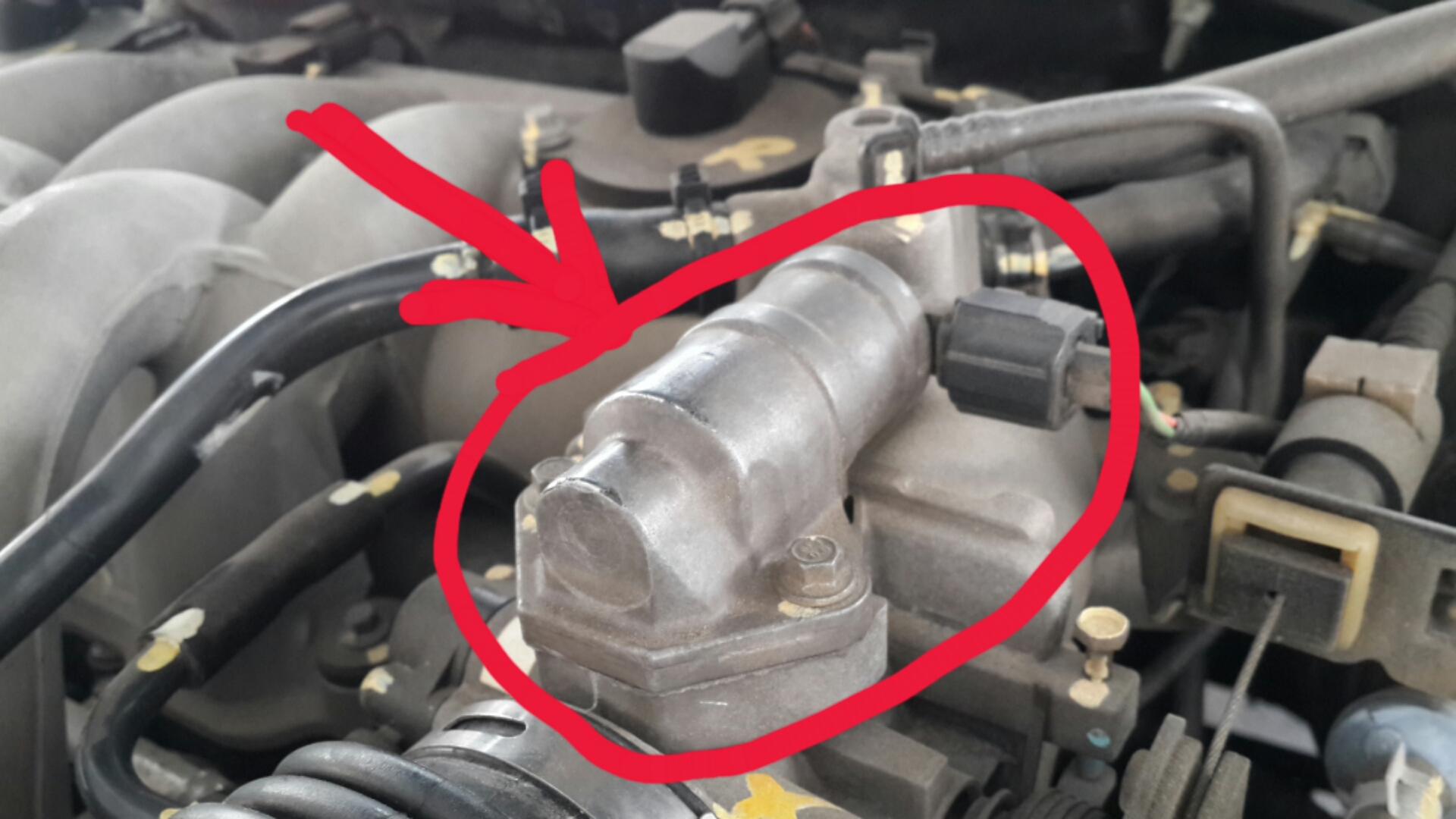

Kindly have a look at the attached pictures and tell me what is the name of this part.
It is causing my car to shake and make strange sounds in tge morning.
X-type 2.1 2002
Thanks

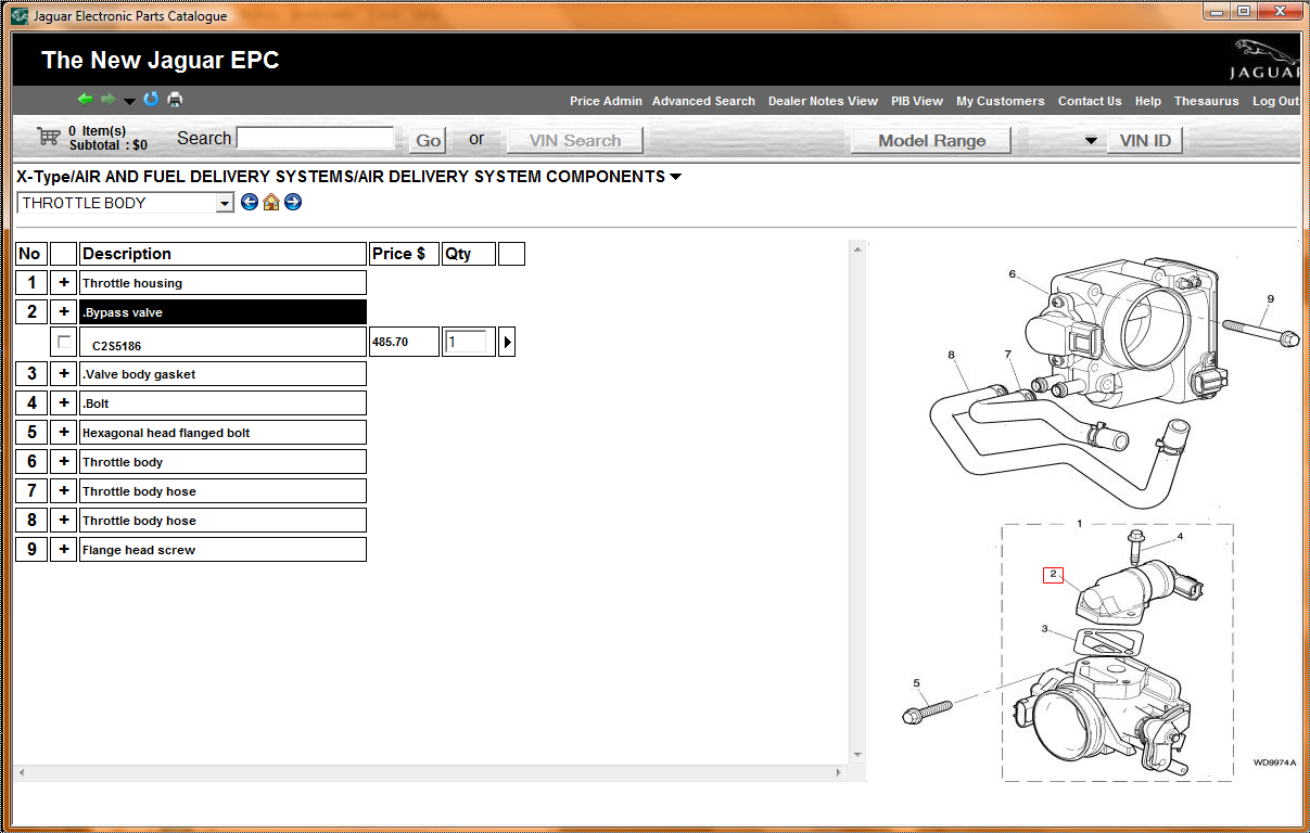

I know nothing about it, but the parts catalog call it a bypass valve.

It's idle control valve.
You could try to clean it with some brake cleaner, they can get dirty and get stuck in one position but best solution would be to buy a new one.

Yes, it is an IAC, and a ratty one will certainly ruin your cold idle, since its job is to regulate exactly that!

Ford calls it a " Throttle air by-pass valve."
