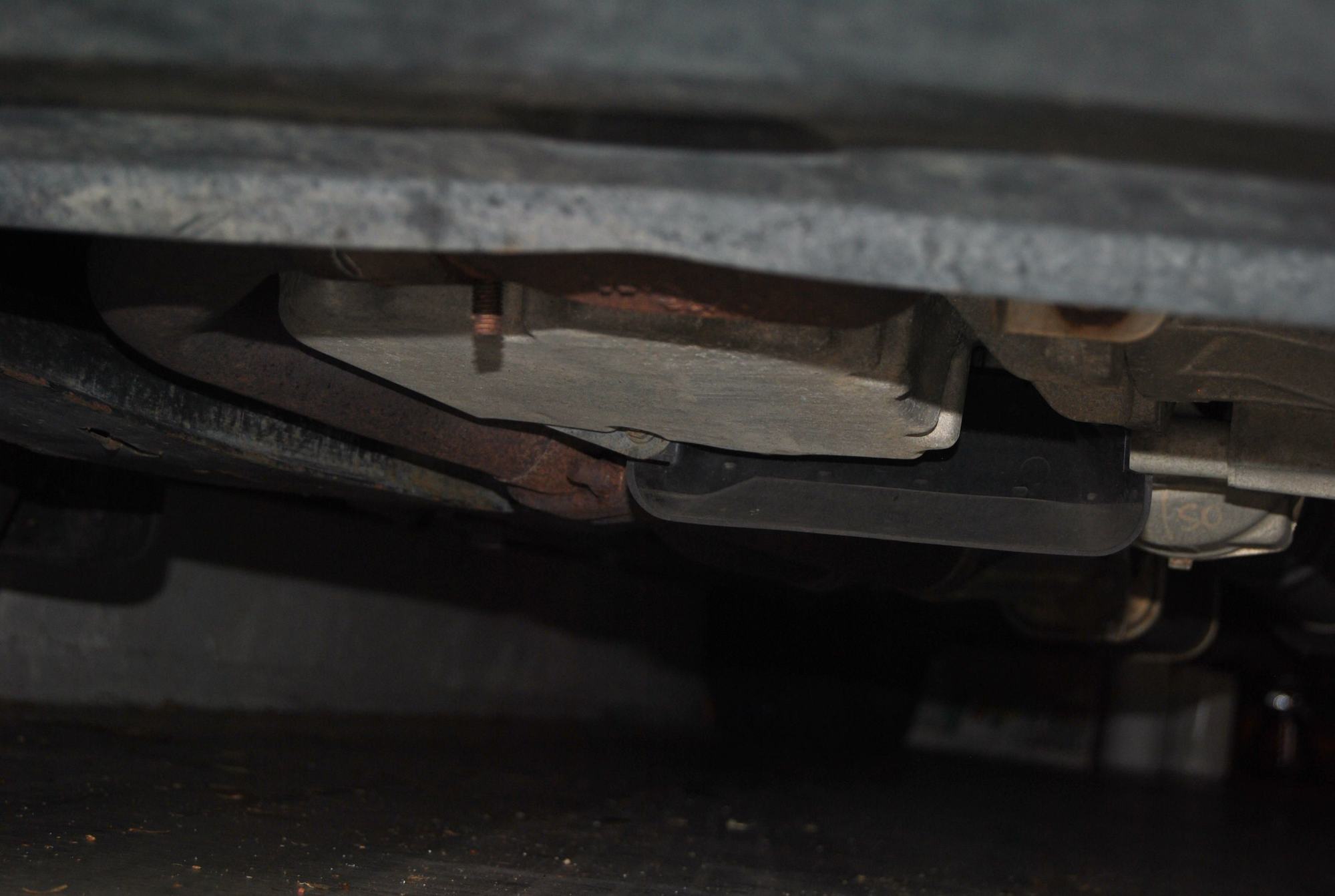

A view of the transfer case air scoop so often missing. It is the black rubber piece just to the right of middle in this photo and it is the lowest-hanging bit under the car - this fact and the fact that it must be removed to access the crankcase drain plug means that it often goes missing. The part number for this duct/scoop is C2S18834 and the single bolt needed is C2S32665.
Thanks again!👍 The visual of the scoop really helps and the part numbers just in case! Plus, fluid changes are always the very first thing done as soon as I can get it in to see my mechanic. 😁
