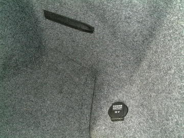

Its a 10" DLS sub.
It will fit where the 'strap' is in the boot on the RH side to minimise the space it will take up as I need it allfor when the 4 of us go drive to France in June (baby buggy,suitcases,etc).
