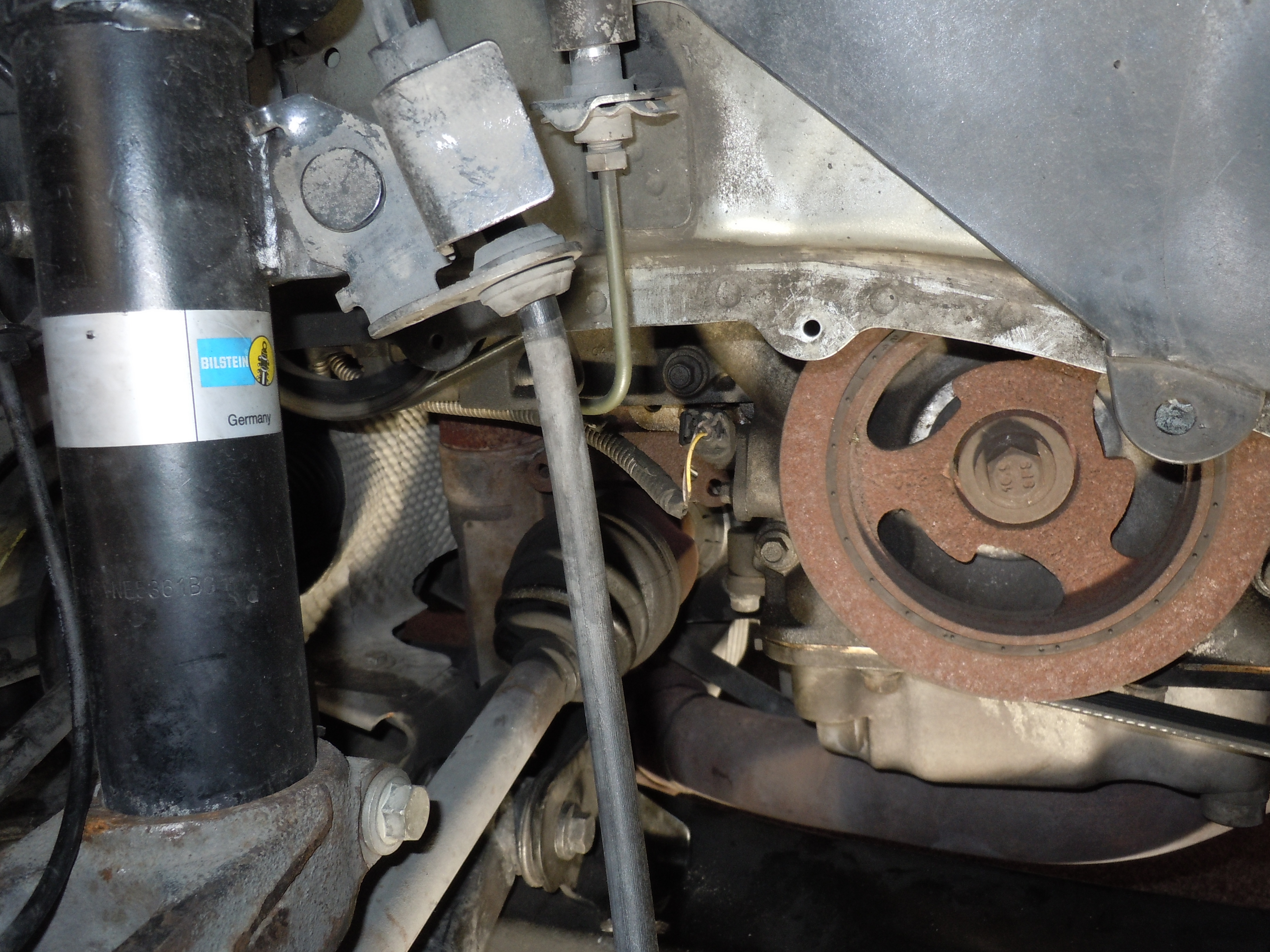

I'd say yes, your noise issue is probably belt and pulleys. To find out though you'll need to take off the belt, tensioner and idler pulleys to check each one. As far as I know the diesel engine in X-Type was never offered in N America, so can't help there. From pictures I find online it looks like the diesel tensioner is different design than that on the gasoline V6. Both engine layouts are similar in that access is through panel in the right wheelwell. Having done the job on my car I can tell you it's tedious because of the tight clearance. How many miles on your car? I don't think you'd need to replace the tensioner itself, but definitely the pulley on it.
