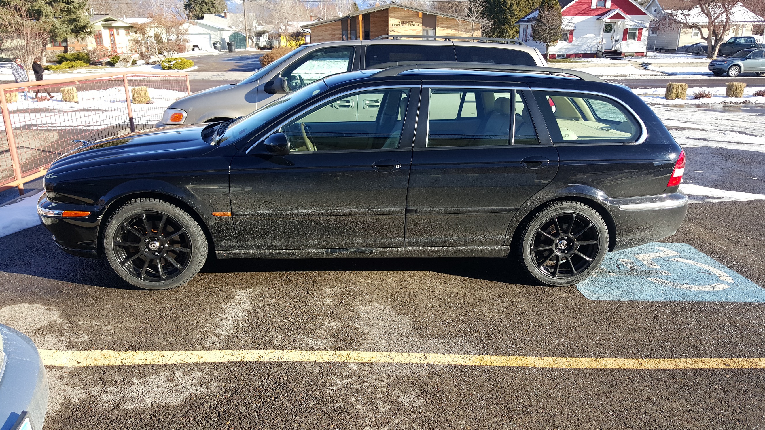

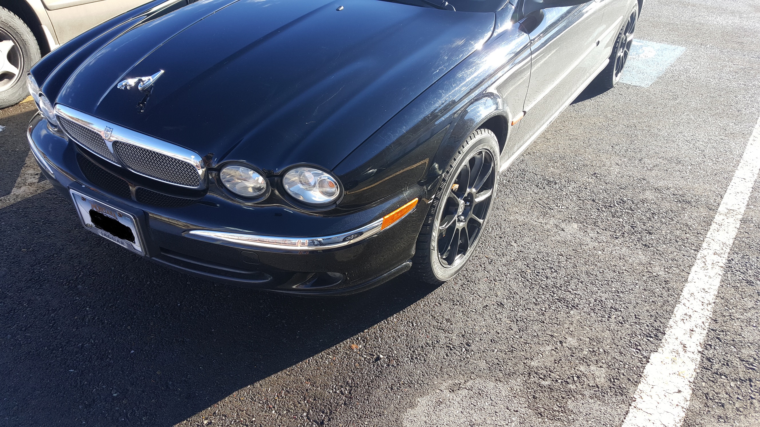

I finally had my studded snow tires and rims installed on the car. I've put on a new hood leaper, and brake fluid reservoir cap. My wife has been driving the car.
I think this car will make a good winter driver.
